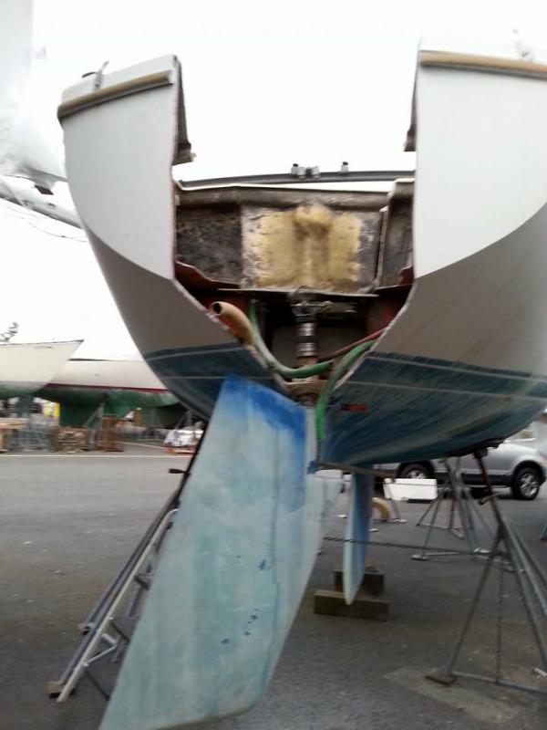

Also FYI: Here is a pic of a cut out of an early Catalina 30, likely from the 1970's era. The stern has been cut off, as the poor C 30 is being parted out. It shows the plumbing connected to the scupper drains. It appears to be garden hose, as it has that unmistakable dark green hose color. I hope its not garden hose in the 1980's era Catalinas! But they sure did cut some corners & used very cheap plumbing fittings in the early days. The gate valves they used were meant for a house hose bib & they only glassed in domestic 1/2" copper tubing into the hull during wet layup & just hoped for the best. Many Catalinas from the 70's are still out there with these badly corroded gate valves that can snap off & sink their boat at any time. Scary thought. This is why newbies should have boats inspected by a surveyor, or at least a boat yard before purchasing. The fiberglass hulls will last forever, but everything else is another story.

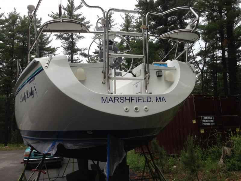

Here is a picture of mine. 19 years and they look pretty good. I wouldn't worry about them unless you see cracks. My wet exhaust is also plastic or marelon but due to the location under the belly I'm sure it doesn't see sun.If yours is bronze maybe a PO changed it out.
