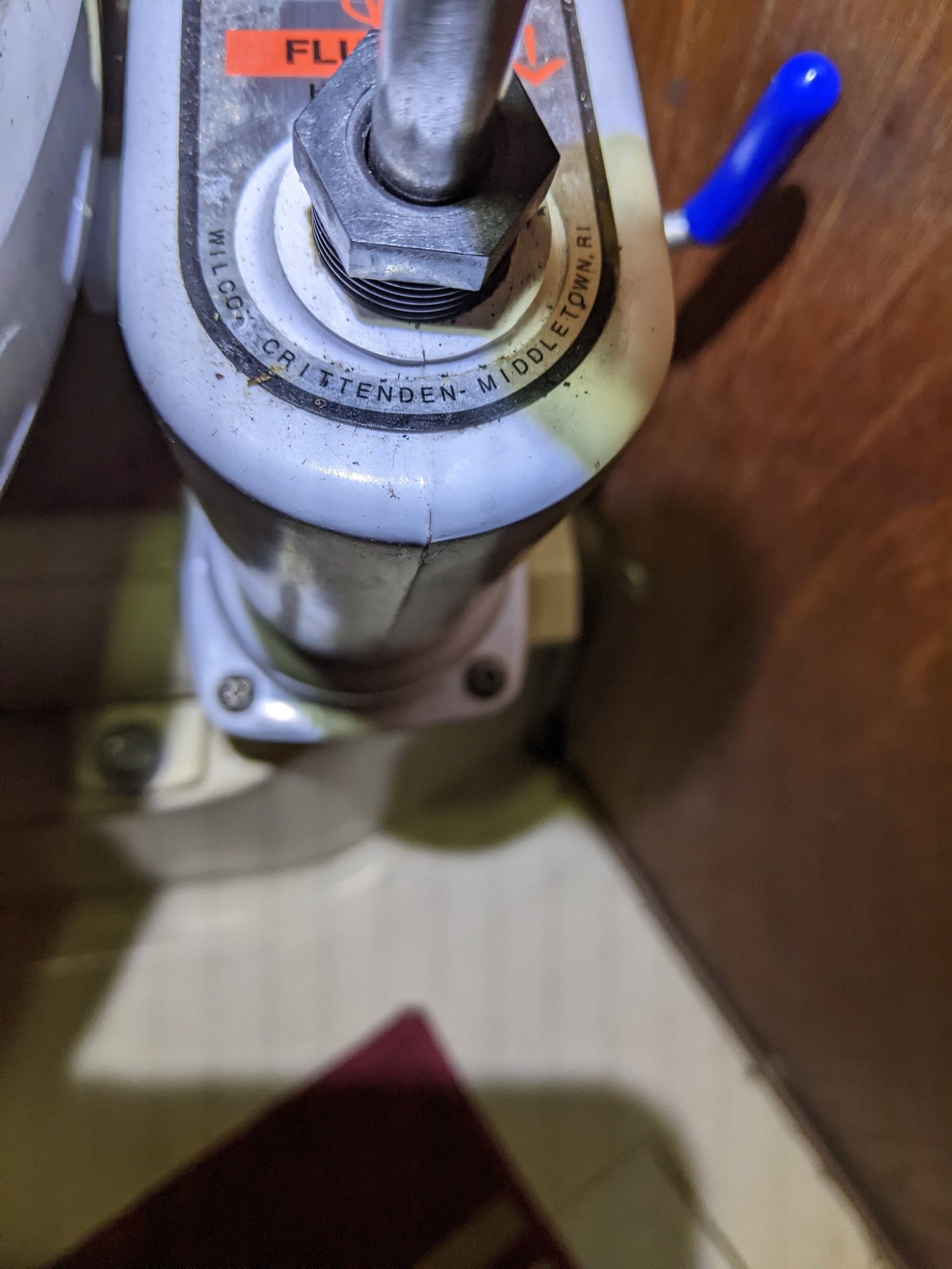

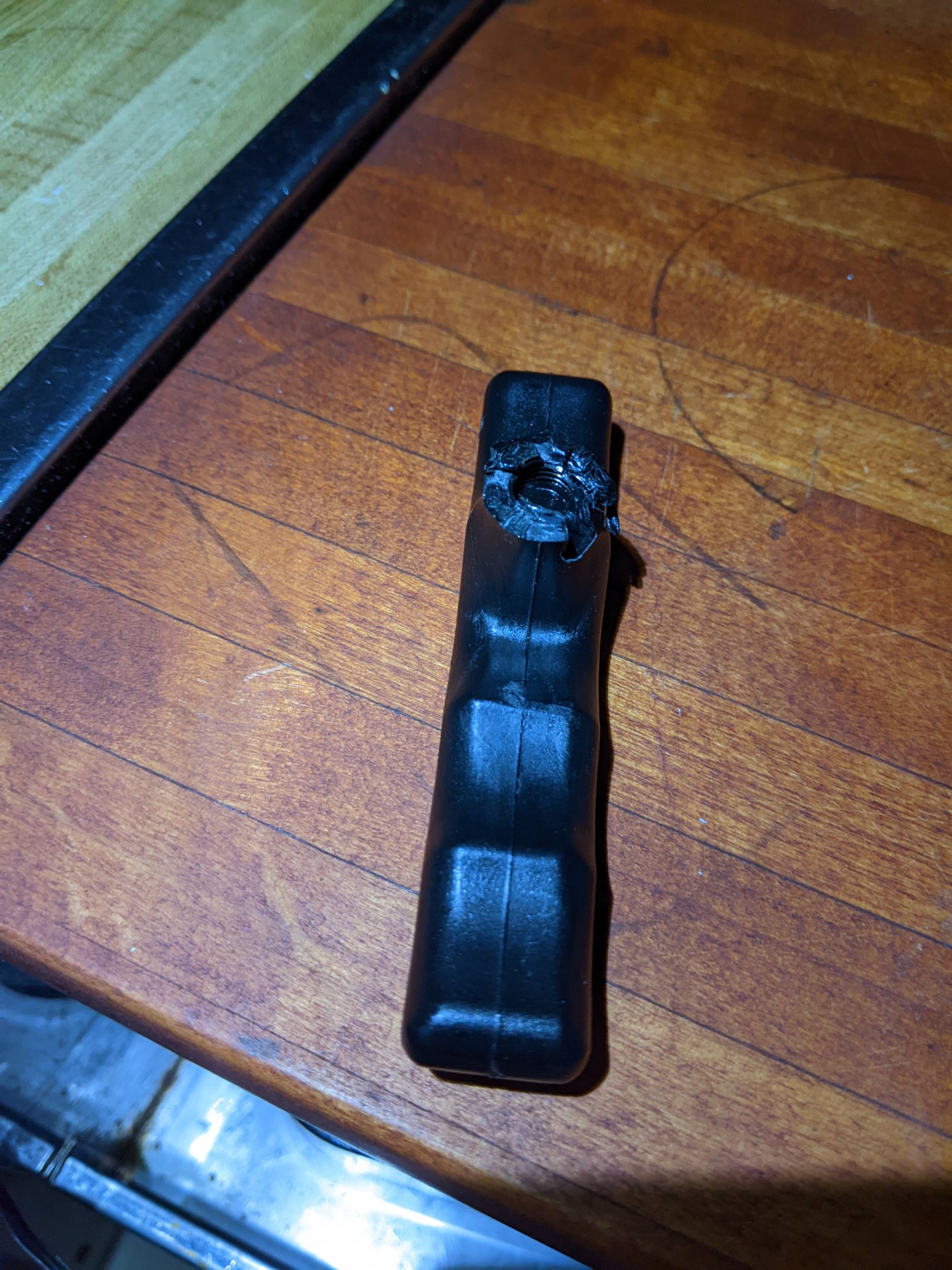

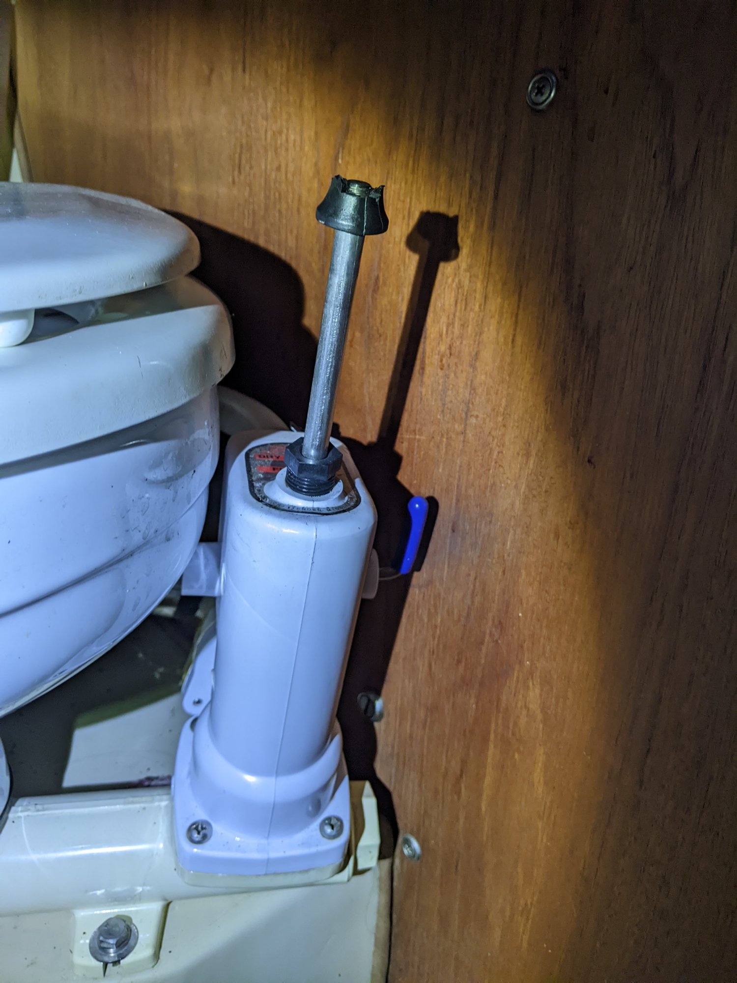

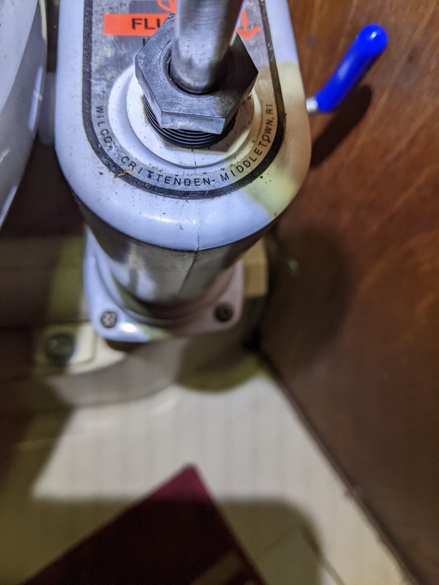

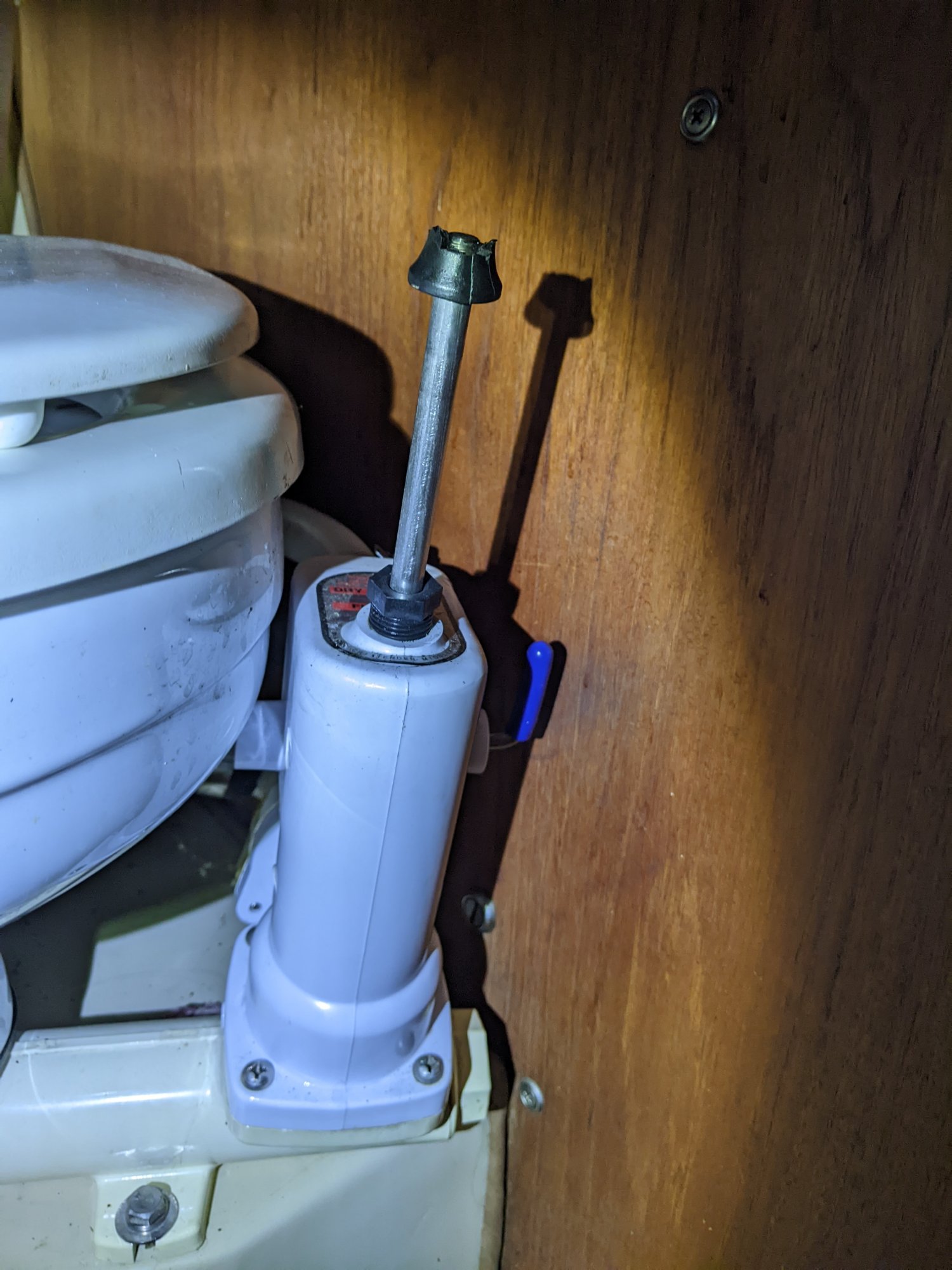

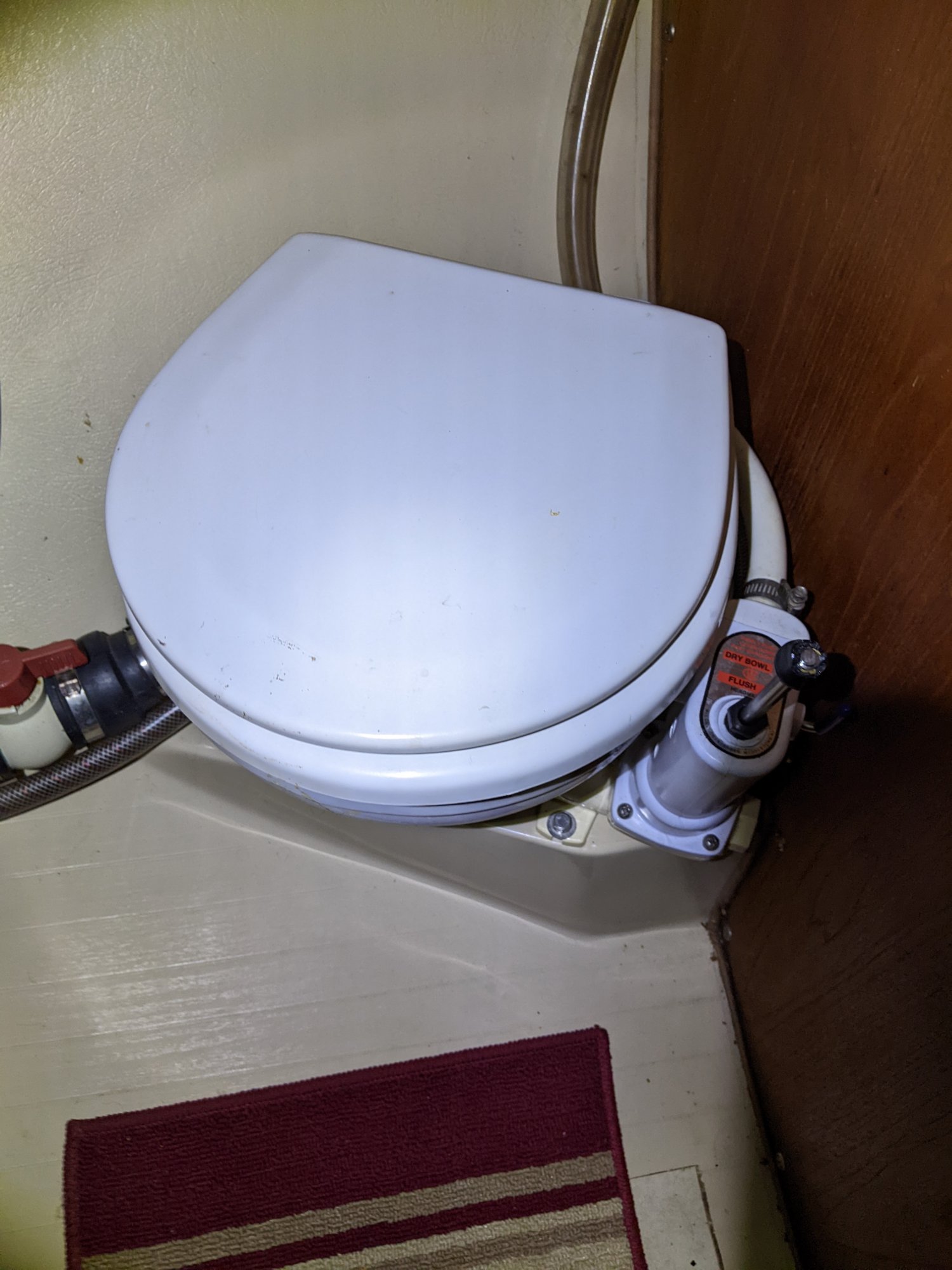

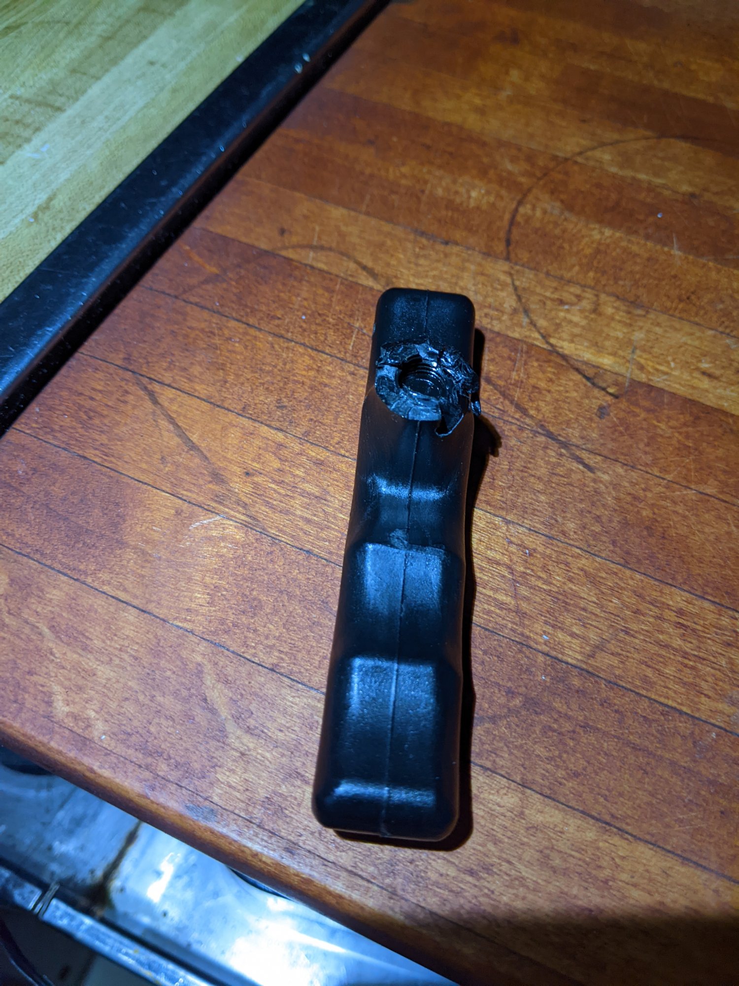

I have a WC Headmate in a 1982 Catalina 27. I'm not sure of the age of the unit or the exact model number. The pump handle broke off and rather than rig something together I'm thinking of replacing the entire head with the Raritan Ph Superflush because the Headmate doesn't work very well (even with the pump handle). Just wondering if others think that this is a good choice for this boat, if it's an easy job and whether the base bolts will line up with the old ones?
Thanks

Another vote for the MSD. Alan, did you just mount the new MSD in the same closet where the old head was? I can see my wife and daughter not being in favor of losing their privacy when I convert the old head closet into a storage locker.

In my 1984 E26-2 it fit on the same platform that housed my conventional Jabsco. We still have an enclosed head exactly as we had before.
My wife actually prefers the MSD portapotty. She's on the tall side and the MSD is slightly taller than the Jabsco was. For her it's more comfortable to sit on. I'm short, but also find using it just fine.
