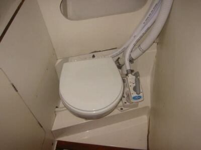

Hi Peggie, have never asked you for advice. Have read many threads on this subject.
I have purchased a PHII to replace my manual Jabsco toilet. I am tired of pouring money into the Jabsco.
When I do this, do I need anything other than a drill to drill the new holes to mount the PHII? I think all the hoses should line up OK and the diameters are the same...
What am I missing?

Should be easy...
I have purchased a PHII to replace my manual Jabsco toilet. I am tired of pouring money into the Jabsco.When I do this, do I need anything other than a drill to drill the new holes to mount the PHII? I think all the hoses should line up OK and the diameters are the same...
What am I missing?
Be sure to read ALL the installation instructions BEFORE you begin!!
Did you remember to buy the vented loop for the intake? (See instructions).
You should be able to use at least one, if not two, of the existing mounting holes...and btw, all toilets mount using lag bolts, so there are never any nuts to deal with.
The flush water intake fitting is on the front of the PH II pump...it's on the back of the Jabsco...so your head intake hose MIGHT not be long enough...you might have to buy a new 3/4" piece of hose.
However, this might be a good time to reroute your head intake line to tee it into the head sink drain. (See previous conversations about this in the HM forum).
And you might want to read this thread before you start...could save you a bit of aggravation.

I did read the instructions. I am assuming that the vented loop is to get the inlet higher than the water line. I did not buy any extra hose, but I will.
Not sure I understood what you meant by putting a 'tee' in the sink drain. Not sure what that does or how to do it. I will see if I can find one of the threads where this is explained.
It needs to be at least 6-8" above waterline AT ANY ANGLE OF HEEL...which on most sailboats puts it about 3' above the toilet.
Not sure I understood what you meant by putting a 'tee' in the sink drain. Not sure what that does or how to do it. I will see if I can find one of the threads where this is explained. Thanks!
Search for "intake odor".

I am having trouble understanding how to put in a vented loop, or even if I need one. I do not discharge overboard since we live in Michigan. My Beneteau 321 does not have one now.
I am not really sure how to put the loop between pump and intake without it looking like a mess behind the toilet....
Should I just buy an extra 5 feet of 3/4" tube and make a large loop under the sink on the intake line?
I have read many of the posts on this and not sure how necessary it is.

All below-waterline toilets need INTAKE vented loop
It has nothing to do with overboard discharge, it breaks the siphon in the flush water INTAKE line started by priming the toilet pump. It also keeps the bowl from filling up with water and overflowing if the toilet is left in the "wet" mode. It's the most common cause of boats sinking in their slips.
Even though a loop in the toilet DISCHARGE line isn't necessary if you're only flushing into the holding tank, a loop can be very useful if it's an uphill run to the tank...'cuz if it's mounted immediately after the toilet, higher than the tank, the toilet only has to push bowl contents over the top of the loop...gravity will get it the rest of the way to the tank. A loop in the discharge line can also prevent waste in the tank from running back into the toilet when the boat is heeled.
You can't put either one under the sink...that's not high enough...loops MUST be at least 6-8" above waterline AT ANY ANGLE OF HEEL...which is about 3' above the toilet. So they have to be mounted on the bulkhead. It'll prob'ly--to you anyway--look like a mess behind and above the toilet. (See attached photo...the small one is the intake loop, the large one is the discharge line) But it's a BOAT...it's not just a floating condo! Condo's don't need protection from sinking...boats do! If decor is that important to you, you can always cover the loops with a nice teak or mahogany box...or, if there's a hanging locker behind the toilet, you can run the hoses through the bulkhead and put 'em in there. Just be sure that the loops remain accessible for service--cleaning and/or replacement of air valve.

The intake vented loop MUST go between the pump and the bowl, as shown in the installation instructions for EVERY manual toilet!
See attached photo...which is the bottom part of the installation shown in the photo above. In that particular installation, there is also a vented loop in the discharge line. However, vented loops in the toilet discharge may or may not be needed...their location depends on what IS needed in a particular installation.
