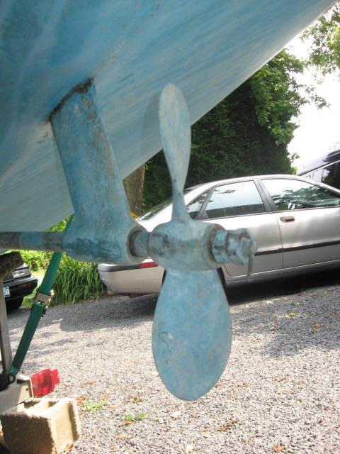

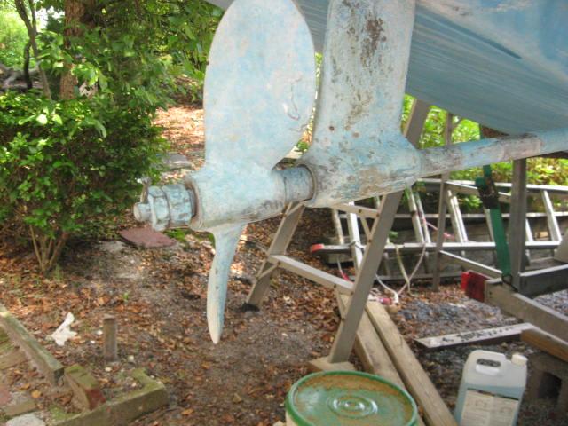

Looks backwards to me too
But if it is a tapered shaft, it is impossible to install wrong regardless of the shaft rotation.
Also, what's with the big space between the prop and nut?

First as far as the bolts go I loosened them, second I sent a second picture to see if u are in fact right with the prop being on wrong. Also the shaft on or off? I think the easiest way (HA HA) to get at the bearing is to that off the shaft NO?
