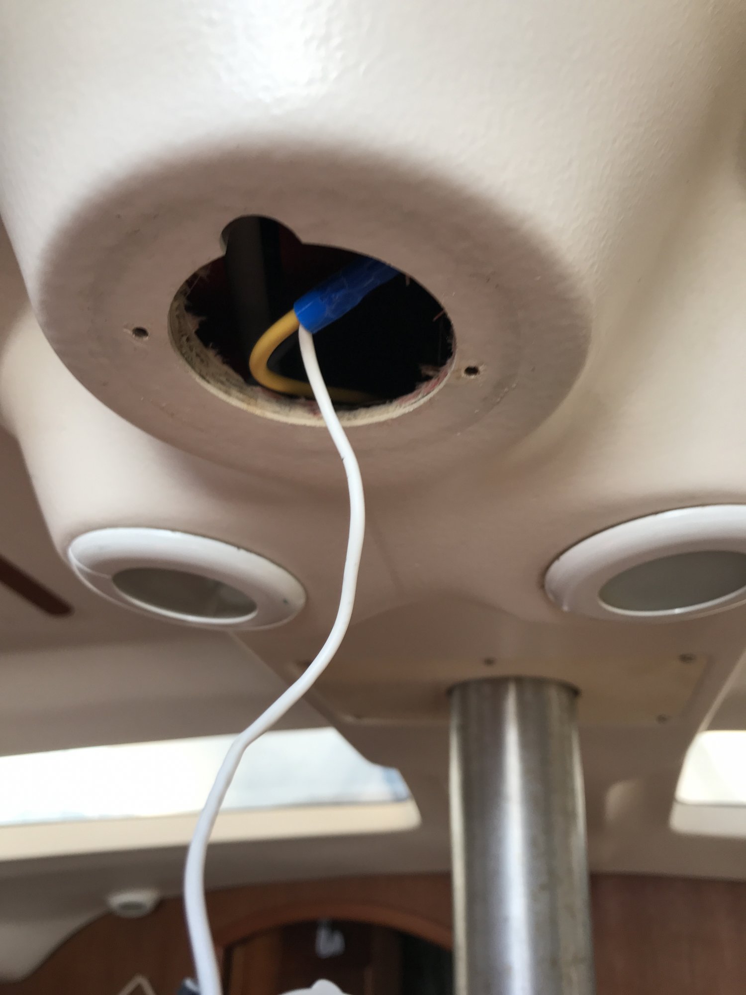

Has anyone swapped out the cabin lights on the 420 that have the off on toggle with LEDs? I have tried two brands of replacement lights that don't fit (West Marine have screw holes inside the cutout). None of them have the switch so they must be controlled by the breaker. Hunter parts forum only offers the always-on version...These in the photo can work as always on but the rest are switched. The second batch I bought don't fit the cutout either.

On my H410, all of the cabin light bulbs have been replaced with LED G4 1.8 watt 220 lumen bulbs purchased on Amazon (much cheaper than WM or your local hardware store). My original light fixtures appear to be the same as yours.

So rather than replace the entire light you just replaced the bulbs? That would surely be cheaper!!! Thanks.

Yes just replace the bulbs. SBO has the LED replacement lights and the light w/switch. Around $25.00 each if I remember correctly
