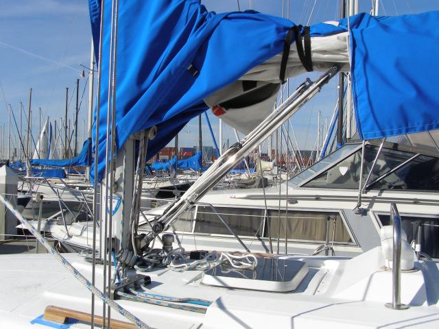

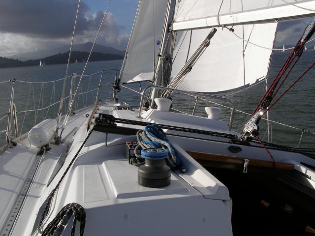

I notice, you don't address my primary argument, that a topping lift can act as a backup main halyard... :D Or my secondary argument, that a topping lift can help shape the mainsail in very light air.
I have no issue with leaving your topping lift rigged to use as a spare halyard. Rig as many spares as you want... you just don't need them for a topping lift if you have a solid vang. I commented on this and the light air trim issue earlier in this thread, see post #7.
Yes, the topping lift can act as a backup halyard. My former lift is safely secured against the mast. As to the second point; a good rigid vang will do the same thing - lift the boom in light air to maintain shape.

In drifting conditions, racers sometimes do lift the boom to shape the main.
Most rigid vangs that I have investigated purchasing can be used to support the boom without any problem.
