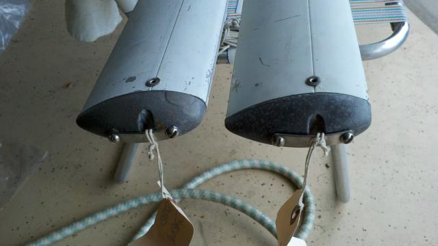

I was going to the lake tomorrow and have it on my checklist to take pictures of the spreader brackets and bring the spreaders home. But with 60% chance of rain and an 80 mile drive wondering if that is smart. Everything you wrote is accurate but we don't know the exact length.
My spreader tips have holes tapped for machine screws on the ends. A small stainless strip bolts over the wire shroud. But I have read that others have the holes on top and use wire to constrain the shroud. So I think that is the correct spreader tip.

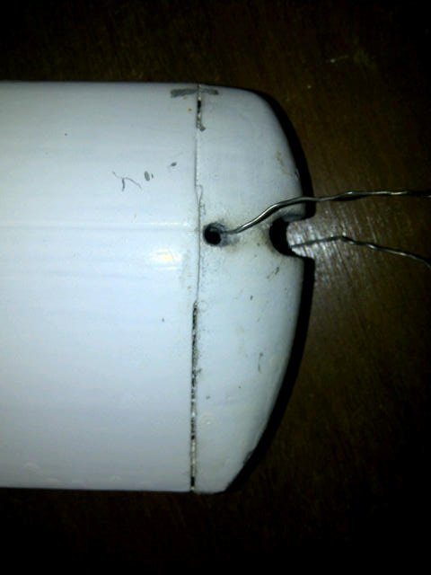

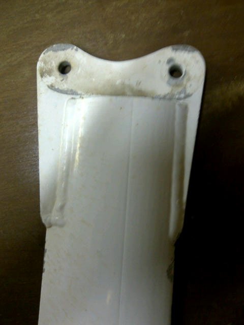

It looks as like you have the correct spreader and tip. The tips on my 1983 37C have one hole for the seizing wire but the dimensions are the same.
The length of the spreader tube is 42 inches. This does not include the tip and the attachment to the mast. The welding of the spreader tube to the attachment in 4 inches long. I hope this helps. If you need any other measurements please ask. Long story but my spreaders are at home so measuring is convenient. See pictures.

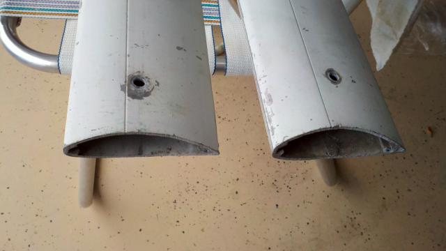

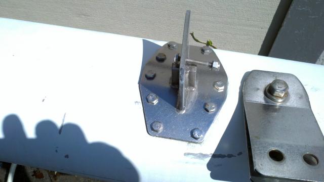

Today I was able to get a closeup of the spreader bracket. And I brought the spreaders home. You are correct about the dimensions. Mine have a length of 41 and 5/16" not counting the tips. But that is measured in the center and the mast end is curved.
