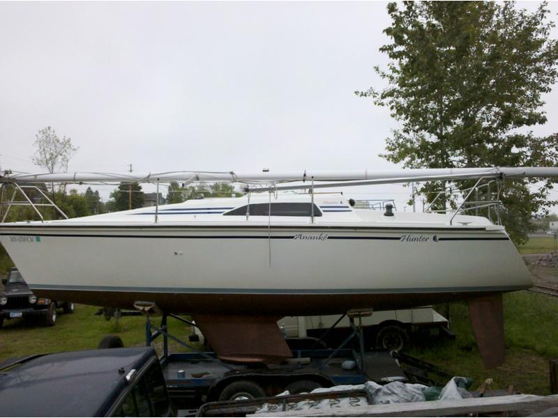

Please excuse if this has been posted before, but I am thinking about replacing the salon portholes on the 1988 Hunter 26.5 I recently purchased. The port porthole appears to be leaking though it looks like there have been some attempts made to seal it. I would really like to replace both with a set of porthole which can be opened.
Internet searches thus far have come up empty, so I ask the general wisdom of the group if anyone knows of a source of replacement portholes for a Hunter 26.5, especially ones that can be opened.

Frank, I am pretty sure no one makes a replacement side port that opens. Some people have carefully cut a hole and put a regular opening port (like a Gray 512 or 414, whatever might fit) into the fixed side glass..

I have seen a couple of the 26.5 windows adapted for opening ports but that takes skill when cutting into the fixed port because if you do not know what you are doing, the whole thing can shatter.

I am of the mind to replace the existing portholes with ones which can be opened, and I feel I have considerable skills (and tools <grin>). Here along the Texas coastal bend it can be very warm, and the added ventilation would have been welcomed.
Looking at the portholes from just the interior of the boat it really seemed like something I could tackle. However looking at the portholes from the outside, I now feel it is just something I will have just dream about <grin>. On to more achievable things.
