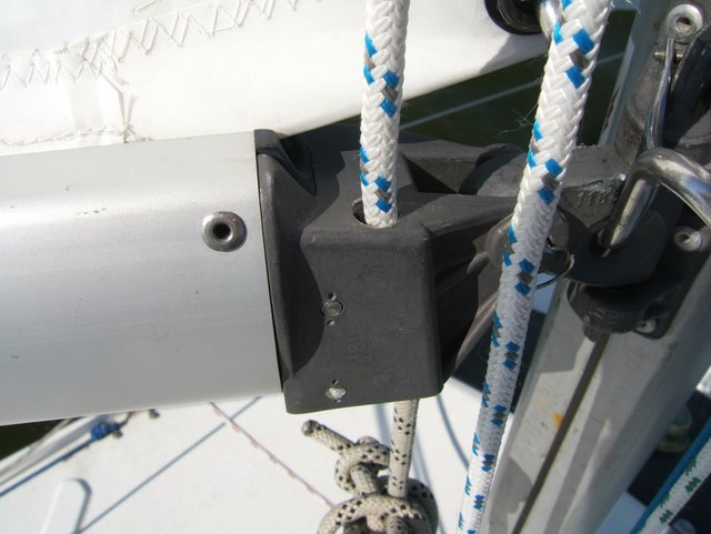

The gooseneck on my Hunter 260 is essentially the same as that in the picture in john's post. A picture of what you have would help a lot. Still sounds like a clevis pin.

I will post a picture when I can get out to the boat this weekend. Mine is different than John's post.
