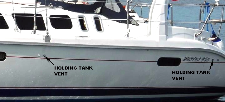

I change tanks, because it smells a lot and it leaks a little around the sensor. I want to take the opportunity to change all the pipes, because of the smell, and to enlarge the vent line pipe to 1 '' . I also want to see if I can put a bigger tank; 26 gal. or otherwise the same, made by Dura Cast. It is certain that the tank smells, I rub a cloth on it and there is a strong smell, and it smells in the boat. Did adding another wind line change anything? Your tank doesn't smell?
Added an additional vent line at the stern. It doesn't improve the smell when sitting at the dock but removes all smell after being out for a few hours. The two different locations on the hull are usually looking at slightly different air pressures due to wind and that's what gets a good air flow going through the tank. No more gas attacks when someone flushes the head at anchor.

Did you drill the holes in your hull yourself?
I have to oversize my true hull vent.
Have you drill the hull bigger, after that filled with epoxy and redrill to the right diameter?
Jan 4, 2006
7,314
Very easy using a hole saw.
As far as drilling a hole larger, my practice has been to pound in a wooden dowel and then use that as the guide for a larger hole. As far as drilling a smaller hole, fortunately I haven/t had that problem YET :yikes:. Should it arise, as you say, I would fill in the hole with FG and then proceed to drill a smaller hole.
