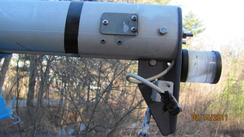

On my Z-Spar internal halyard mast, they installed two bent 5/16" bolts through each side of the mast with the threaded bolt protruding through two holes in the mast head cap for the nuts and washers. Maybe your mast head is attached in a similar way.
In the pic, you can see the head of the bolt in the side of my mast on this side. There is also another bolt on the other side. This is what holds the mast head to my mast.
