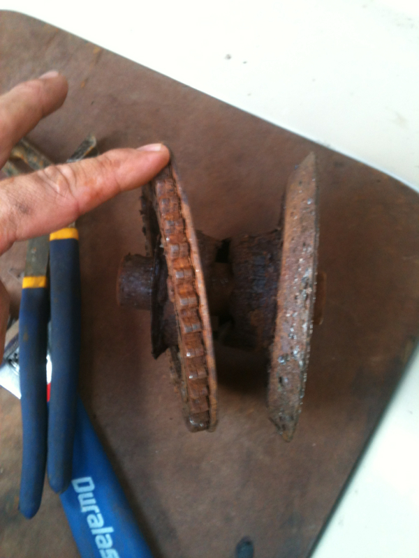

i pulled my winch out today and has suffered the effects of salt water...I think it is the original winch to the boat (hull 6850) it is a red fulton 560. So looking at the CD catalogue, it appears the replacement winches are Dutton-Lainson. Can anyone who has purchased a replacement winch recently confirm the manufacturer and model number?

i found the right winch - Fulton K1051. The winch handle is too long though, but you can also buy the correct handle - 7" in think. You can find the winch online for $90 to about $150. I am heading to Fisheries Supply where it lists for $114 plus I get a 25% discount.
UPDATE just ordered the winch, $83.27 with my discount. And I already have a new 8" handle to use that is on my trailer. I will just swap them.
