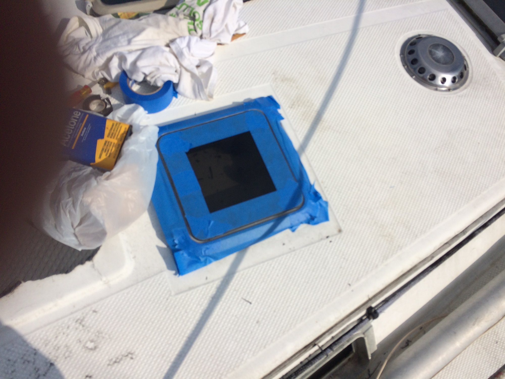

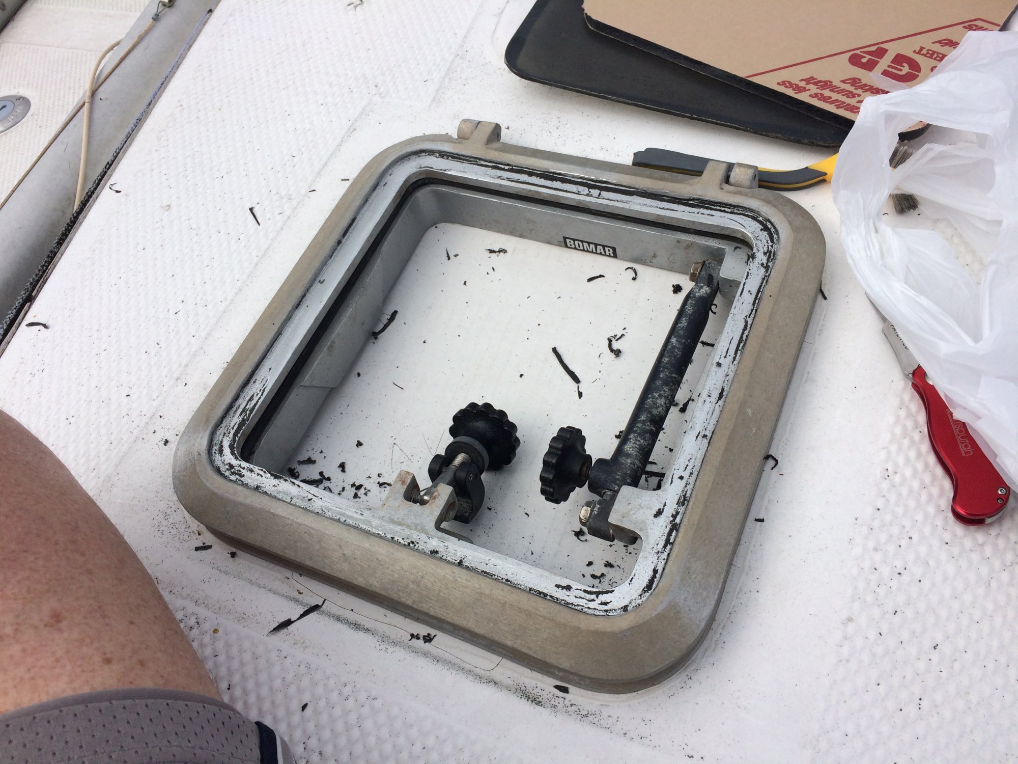

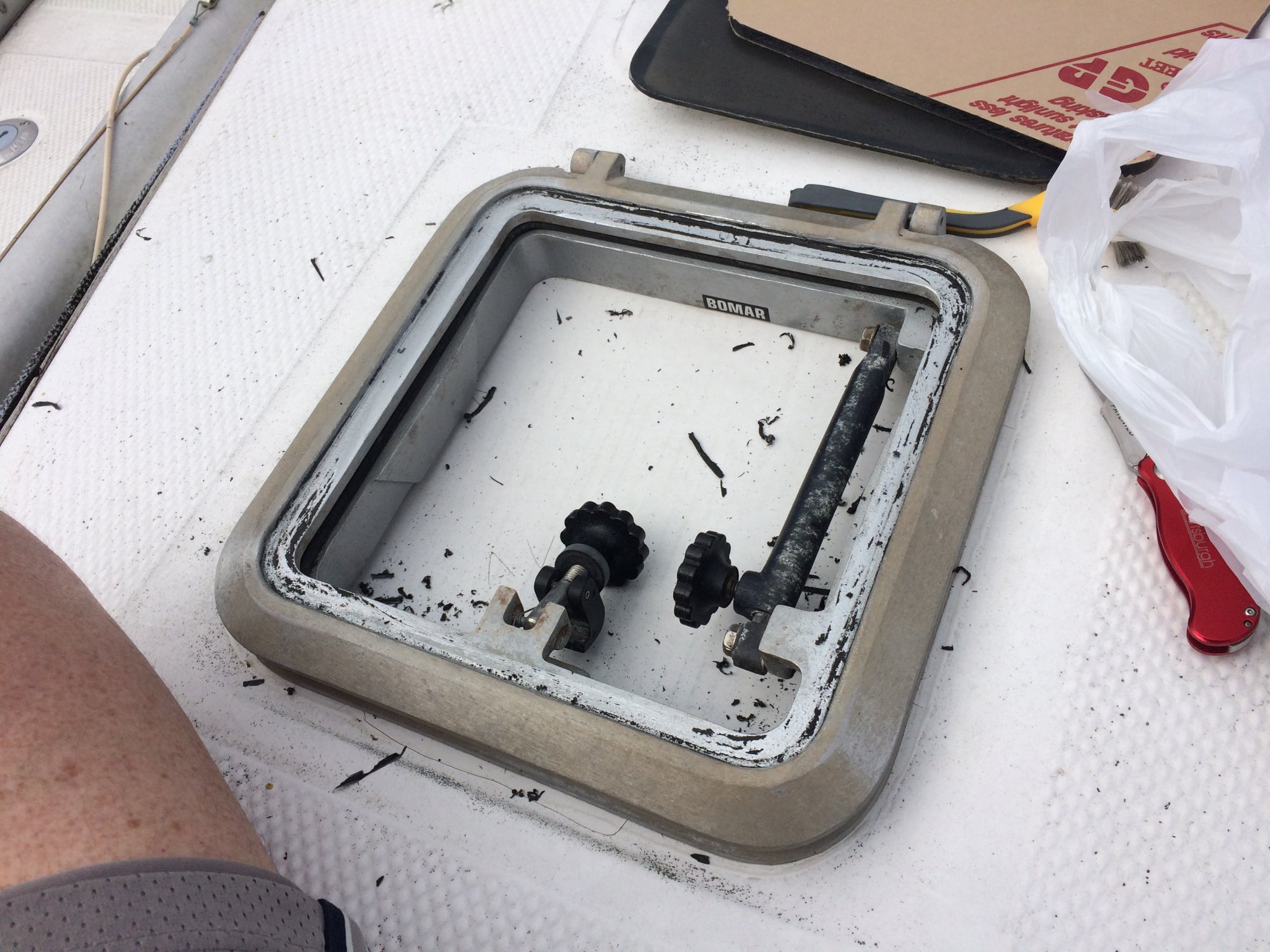

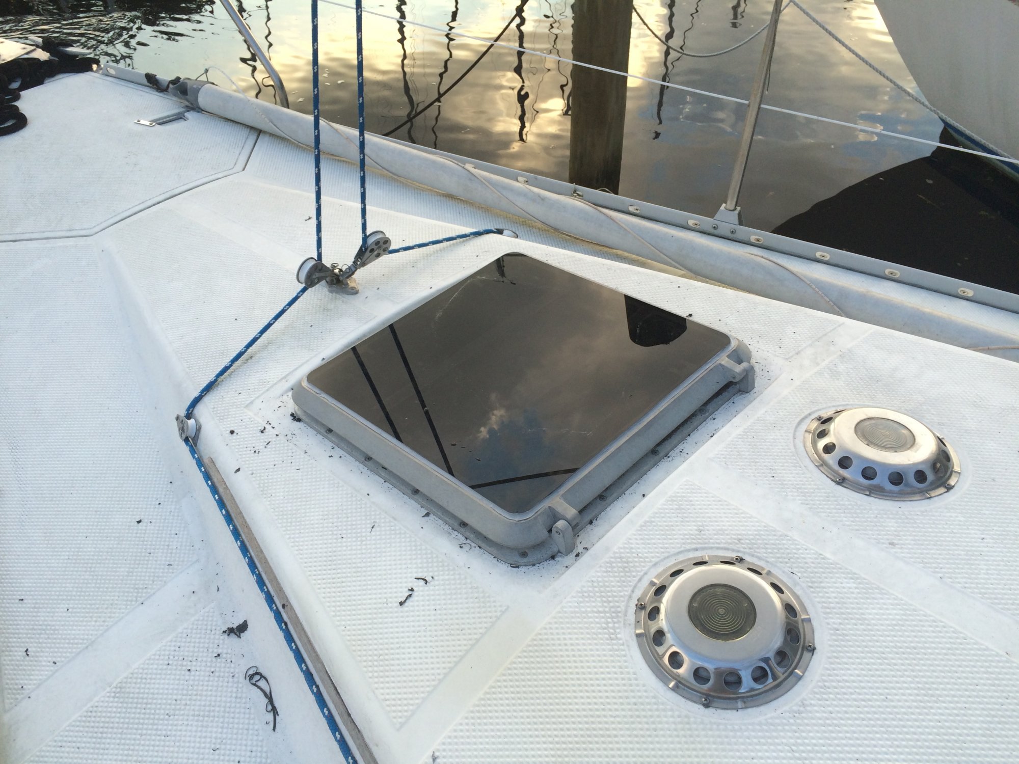

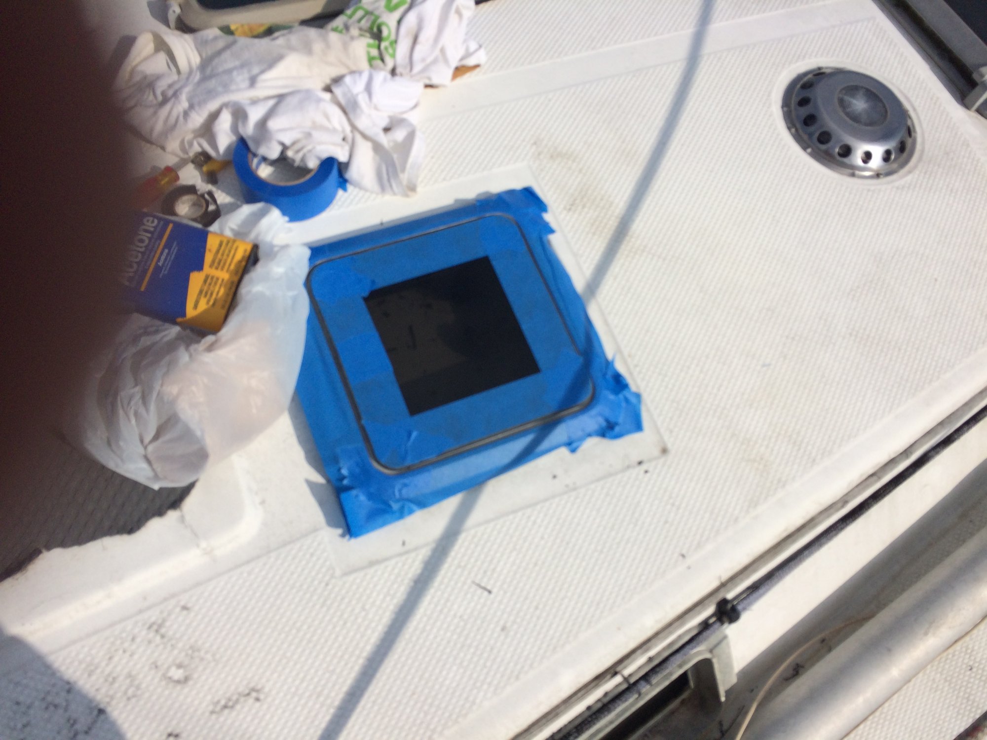

It is not a bad job to do yourself.. I measured VERY carefully and ordered a pre cut piece of acrylic (plexiglass) from TAP Plastics in Stockton California.. The lens, custom cut with radius corners was about $70. It was thicker than original at 3/8 and 19 9/16 inches square with 1" corner radii.. Mine had no holes in it.. For a Bomar hatch.. don't know the number.. I used gray Dow 795 for sealant/adhesive and masked carefully to get a decent appearance. Took a couple of hours to get everything cleaned and re-installed.. did all 4 of the hatches and everything fit perfectly. The two "in progress" pictures are of a smaller hatch, but I did the big hatch the same way. Tape a cover inside to keep the debris out of the cabin.
