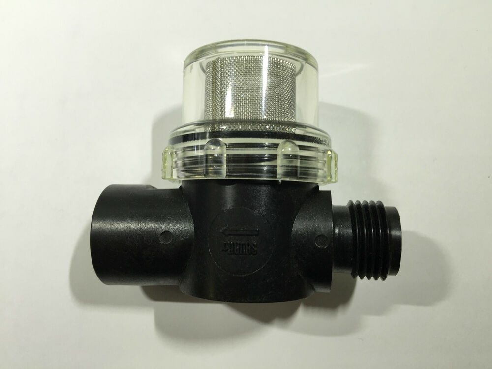

I've replaced many fresh water pumps on many Catalinas. Pretty straight forward. I would recommend finding a pump without an intergrated filter - I would recommend putting in an in-line filter (easier to clean). I still have the original water pump on my 2000 Catalina 34 Mk II and cleaning the filter is a pain since its integrated into the pump itself. If/when I replace it I will add an in-line filter (like the one pictured below)
Likes: BigEasy
