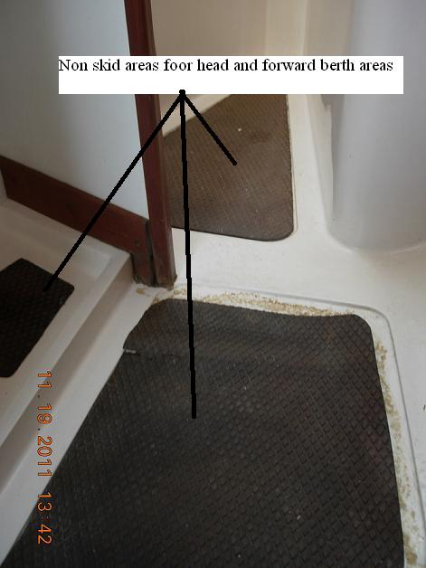

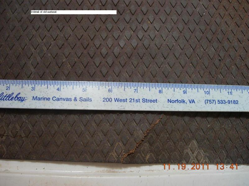

Am refurbishing my '81 H30 and need to find a source for the precut, non-skid floor that sits in the indentions of the fiberglass floor pan outside the head and in the V berth. The material has a raised 'diamond' pattern and was glued down. Given the small indention in the floor, the material is not thick, perhaps 1/8". Any alternatives that have worked?...Thanks

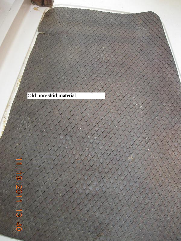

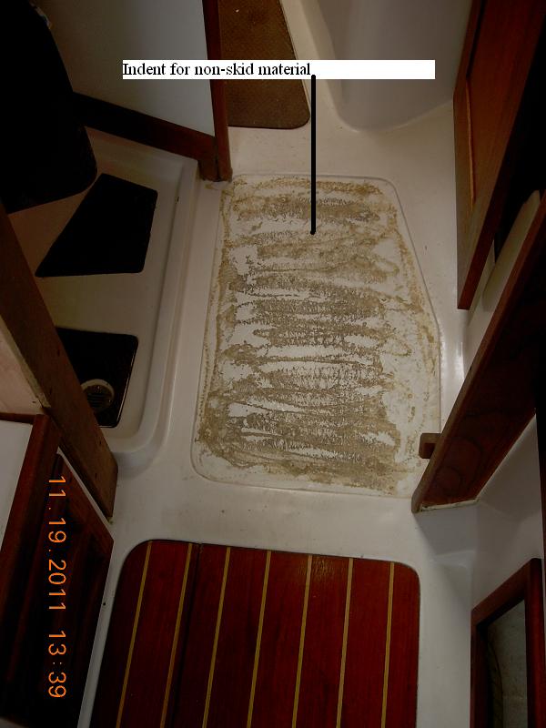

On my1983 H-3 I have the same indents in the main cabin, the head, outside the head and in the v- birth.
The main cabin had thin teak plywood and a diamond Treadmaster type product in all the other areas. The plywood was beyond repair and the diamond flooring just plain gross. I carefully removed the old flooring to be used as patterns. I used a straight edge razor, paint thinner and then goof off to remove the old glue. (Be careful using Goof Off the fumes are strong and you'll need lots of venting)
I made up replacement sections out of teak colored solid vinyl planking sold in Home Depot. The vinyl planking glues to itself by pulling off a paper cover and not to the sole of the boat. I assembled rectangular sections and then used a straight edge and razor knife to cut the section to the shapes using a belt sander where necessary to clean up the radius edges. I was careful to assure that the strips of planking ran fore/aft.

Benny...will take a pic this coming weekend and post. But I think the tread master material is what I am looking for.

Thanks...got a 'deal' through Wet Marine, full sheet of "sand-white" for $77 on their web site. Not the color I was looking for, but could not refuse the price.
