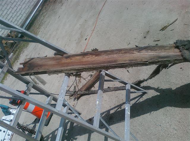

This week I managed to get my Venture 25 off of the trailer and sent it off to be sandblasted and repainted. I will of course replace the lights and breaks, but am wondering what to recover the bunkboards with. They looked like they were covered with some old type of carpet which was rotten, but what do I use? Any suggestions?
