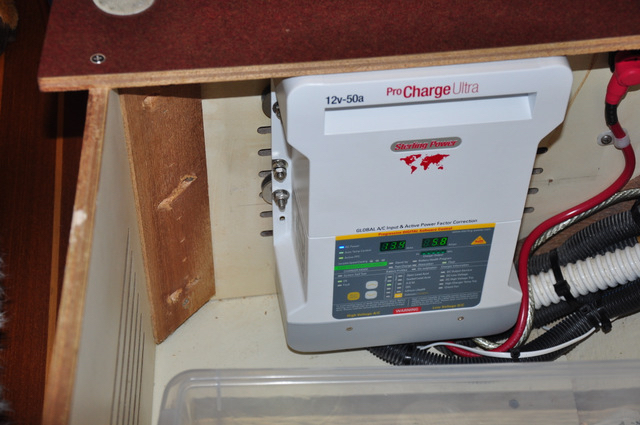

Noco = No... Nothing "genius" about it except for some slick marketing.
Sterling ProCharge Ultra = Yes (same charger as below)
ProMariner Pronautic "P" = Yes (same charger as above but be sure it is the "P" version)
Equalizing works both the Promariner and the Sterling have an equalization feature.
The Noco has dual outputs but they really lack any program-ability (because they are waterproof) so the batteries really need to fall into the the preset, pre-chosen, pore-defined voltage range in order to work with them.
They are not well suited to GEL, obviously, but they can work for some AGM and some flooded batteries, though Trojan and other deep cycle batteries prefer 14.7V - 14.8V, which the Noco simply can't do.
The Noco chargers also don't have temp compensation and don't do a true float. They cycle in and out of absorption and key back on at somewhere around 12.8V and go back to 14.4 - 14.6V, then eventually shut off again, drop to 12.8V and repeat the process. This is a cheap and dirty way of calling a single stage charger "smart" when it is anything but.... A true float voltage maintains the battery at say 13.4V steadily while the Noco bounces on & off using ceiling voltage of 14.4 - 14.6V and a decay voltage of 12.8 or so.
The Noco is not the best choice for a boat running dock side DC loads or for fast charging. Also you don't really get a 20A charger you get a 10A & 10A but the start battery is taking 0.2A, or it is off, so the other 10A goes to waste.
A dedicated 20A distributed by demand charger, like the two mentioned, would give 19.8A to house and the 0.2A to the start via an ACR or the BOTH position or an Echo type charger or direct wired to each bank.
"Desulfators" don't work for "desulfating". I have spent months testing various desulfators and found none that did much of anything measurable in terms of "desulfating" and regaining usable capacity.

you already know what to do when you said sterling.... there is an article on installing a battery charger by mainsail and the exact charger is the one to get they come in 20 amp and up i have a 40 amp on my boat ...maine recommends 20 % of bank capacity which in your case would be about 80 amps but i think based on what and how you use it a 40 amp would do just fine it would just take a longer period of time to recharge..but it is sailing and supposed to be a lackadaisical time so whats the hurry and it does have all the bells and whistles you like

Yep... The Sterling has a 5 year warranty as does the Promariner.. Xantrex = 2 years and the newer ones often die right out of warranty.....;) Got a dead Xantrex 40A sitting on my bench as I type this...:doh:
In all honesty you guys are good candidates for a big inverter charger such as a Magnum with 100A charger...

I will second Maine's recommendation of the Pronautic P. I have installed quite a few and will be installing one on a Bayliner tomorrow. The only other I would rate very good is the Blue Seas.

The Blue Sea charger is also excellent but has limited sizes just 25A and 40A with bigger sizes reportedly due out next year sometime..
