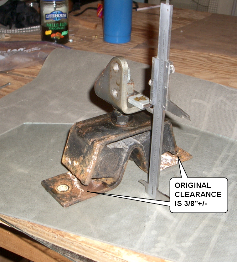

Greg, if you have Yanmar mounts, keep an eye on them for clearance :
I was forced to replace one due to leakage of sea water and diesel fuel on it for some time. Looked like an interesting job so replaced it one winter. This shows measuring the height, as removed, in order to set up the new mount for installation.
The other three mounts are 24 YO and the replaced one 20 YO. All still show 3/8"± loaded and no problems with vibration. I think they may last the life of the boat if protected from fuel leaks.
Thanks Ralph,
I will measure them sometime this winter. They look OK (no oil or diesel spills on them,), but they are probably 34 years old. I have never found receipts or maintenance log entry to suggest a PO replaced them (I have owned the boat for the past 8 years or so of its 34 year life .
To @Haydon walker’s point, I assume if the rubber is shot (or weak), it would manifest itself in smaller clearance as the rubber squishes more and more.
