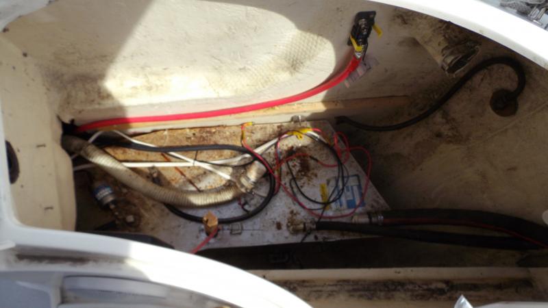

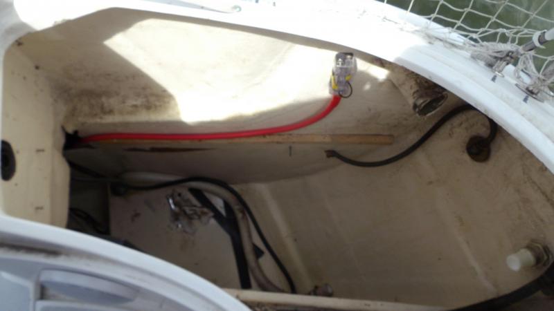

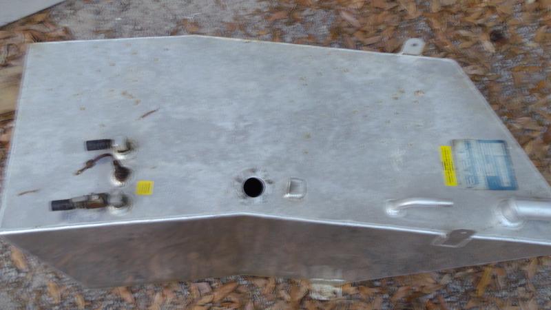

I replaced the fuel tank in my 1994 (produced late 1993) 40.5. I didn't have a known leak but based on other info it seemed it was time to replace it because it will leak soon. Boy was I right!!
It came easily out the top of the port lazarette single handedly. I was surprised how easily it lifted. I'm sorry I didn't get any pictures of that but since I was by myself I couldn't lift the tank and take a picture. Here are some pictures of the old tank and the new tank.
The bottom had corrosion that had not obviously been leaking but when I probed the spots the pick went through like it was going through wet cardboard. There we several places that would be leaking very soon if they were not already weeping.
Now that the tank is out if somebody is handy with Aluminum work they are welcome to have it free, otherwise it goes to recycling if they will take it or to the trash. The bottom will have to be cut out and a new bottom welded in place. Shipping would be vary by location. $169 to Jacksonville, FL, $217 to San Diego UPS ground. It would cost maybe $25 to package it so total all in cost would be the packaging and the actual cost of shipping.
Here are the pictures

Jim,
I replaced the tank with an Aluminum tank from the original manufacturer, Ezell. They are in Perry Florida and are still in business. They are making the tanks from thicker 0.125 in aluminum and had the original drawings. The original was .09 in. They customized it a little by putting in two clean out openings and 3 pick ups and 3 returns. (Yanmar propulsion, Nextgen 5.5kw generator, and a future fuel polishing system). I figured with the thicker Al it should be good for 20 to 30 years, especially if I keep it clean inside. I didn't want to sacrifice size for a tank that did not fit in the space efficiently.
I have no affiliation with Ezell, but they are great people and the price, while not cheap, was much less than other quotes and frankly, less than I expected. I am very pleased with the whole process. :D
Yes, people with boats of our vintage need to be very attentive to the Aluminum tanks. If you wait for the leak you may be faced with a huge EPA fine if it gives way when you are not there and the automatic bilge pump kicks in and pumps it overboard. The fines and cleanup costs will be huge and I doubt if Insurance (even Boat US) will pay for a maintenance issue that spills fuel, though I don't know for sure. :confused:
