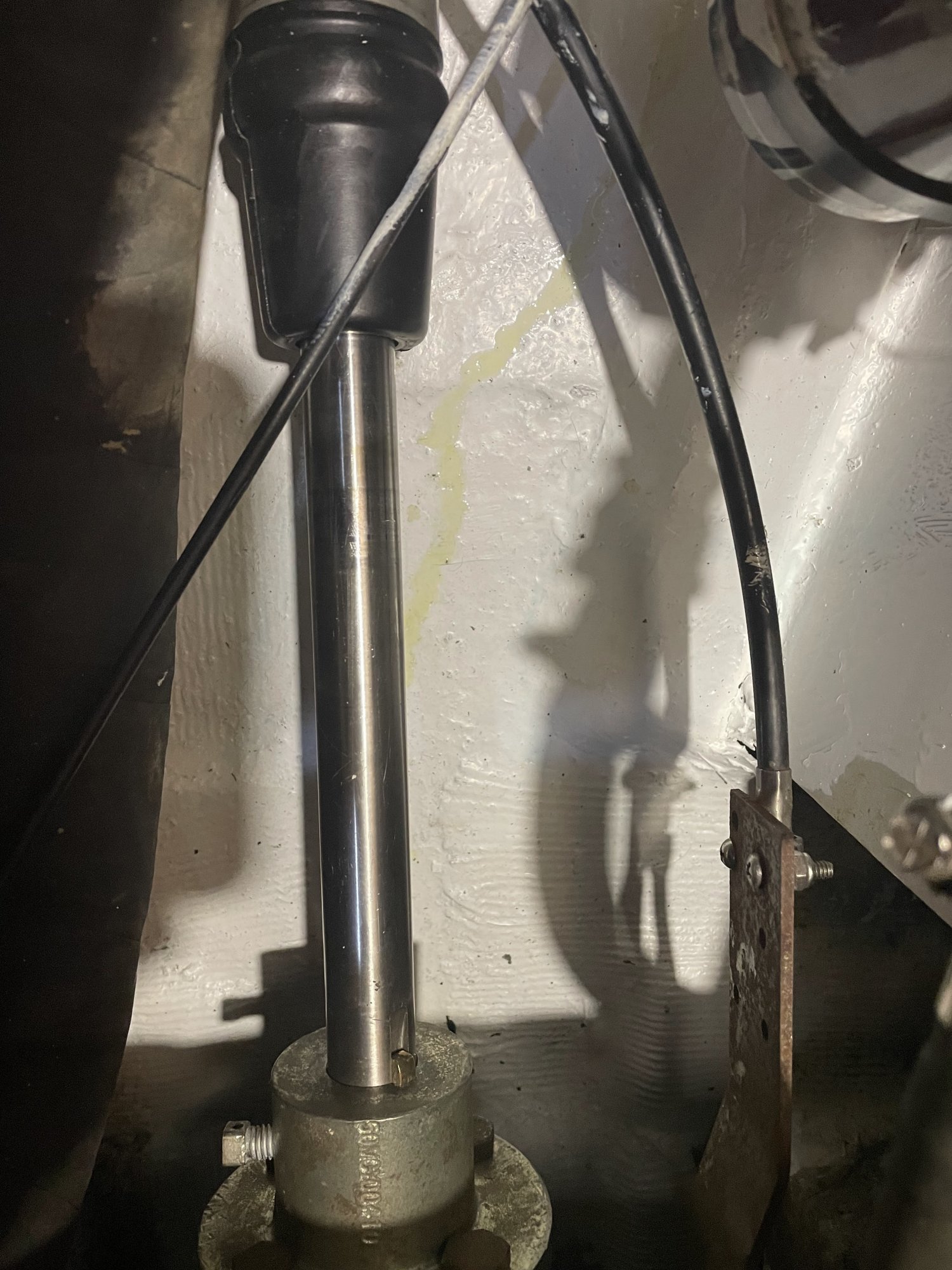

I going to yard soon . While there I might want to replace the Volvo Penta shaft seal with a PSS /PYI shaft seal to forget the endless leaking/// Good idea "? anyone done it? There is also what looks like to be a ss shaft retention collar just behind the coupling. It looks like its a zinc donut but its actually stainless steel. Must be removed to move shaft aft while installing a new shaft seal. Is this from factory? Thanks all.

Why is the Volvo leaking ? How old is it?
i just installed one this winter on my O’Day 322, so far no major issues. I had some leaking at the stern tube, where the rubber stuffing box is clamped on. I had to shim the clamp to get it to stop leaking…next winter, I will probably add a layer of fiberglass to the stern tube.
As far as the zinc donut, probably added by a PO to keep the shaft from slipping out of the boat if the shaft came out of the coupling.

Thank you Greg! It is a stainless steel collar.Just looks like a zinc shaft donut

1992 Moorings 445 acquired in 2000. Like you, had continuous leaking with Volvo seal. Even after two replacements. Installed PSS seal in 2005 and haven't had a leak or other problem since. Now in the yard and renewing the seal for the first time, because I didn't realise that it should have been changed after 5 years. Annual inspection never showed any problems ( not that I am recommending extending the change out period). That was my error and I may be lucky. The SS "donut" is the rotating part of the seal which interfaces with a stationary carbon face. It is moved along the shaft and secured to compress the rubber bellows part of the system.
