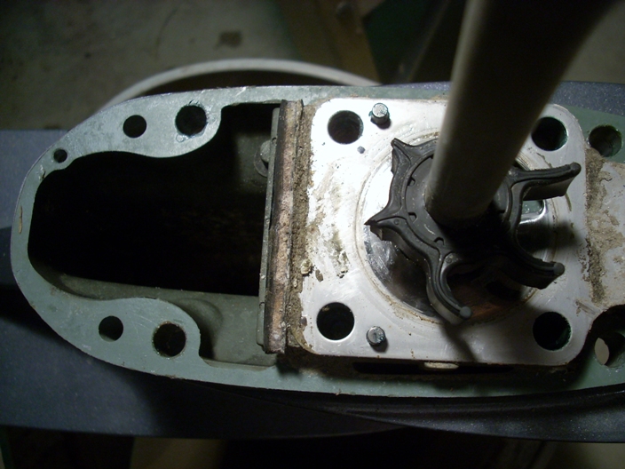

I like to check mine every year or every 100hrs. REALLY, REALLY didn't want to bother changing it this season because the last one looked fine, hadn't used it much and it has the potential to be tough to get out, blah, blah. I grudgingly pulled the foot on the OB on our 26 to find 2 blades missing and one jammed into the outlet port. Egads!!!

I know I'm happy I did. There is just
no right time to fry a motor for lack of a $10 part.
