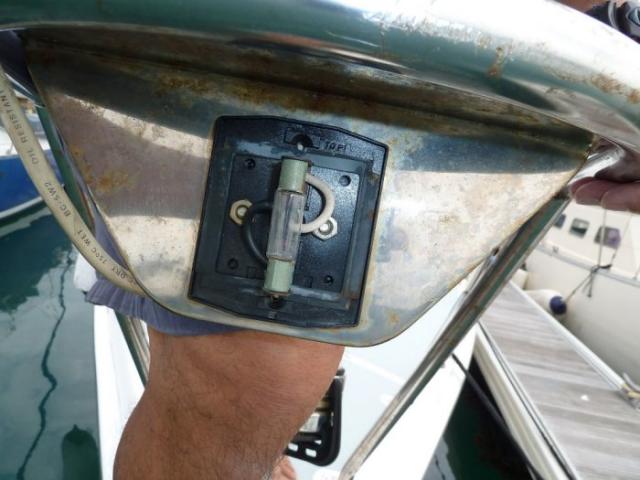

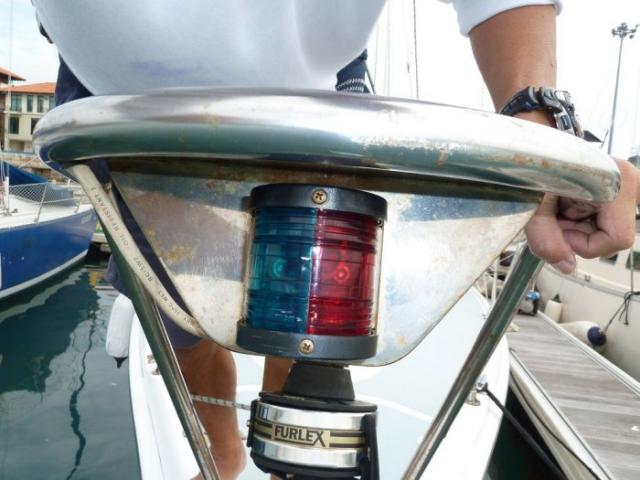

What replacement can I use for 1987 Hunter 31 - Bow pulpit, bi-color navigation light. Two sheet-metal screws hold present light to a vertical stainless steel 2" x 3" plate welded to bow pulpit.
Due to damage, I've changed my Hella to Aqua Signal 25. I retain the holes on the SS plate but drill to fitting holes on the Aqua Signal. See pictures.
