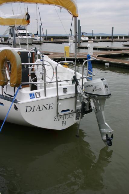

While I will agree that the outboard does take away from the looks of the boat, it's not that bad. It's also not that difficult to control the outboard from the cockpit. My old Honda is much quieter than the Renault and is very smooth and extremely reliable. The Renault will rattle your fillings at lower speeds :eek:
