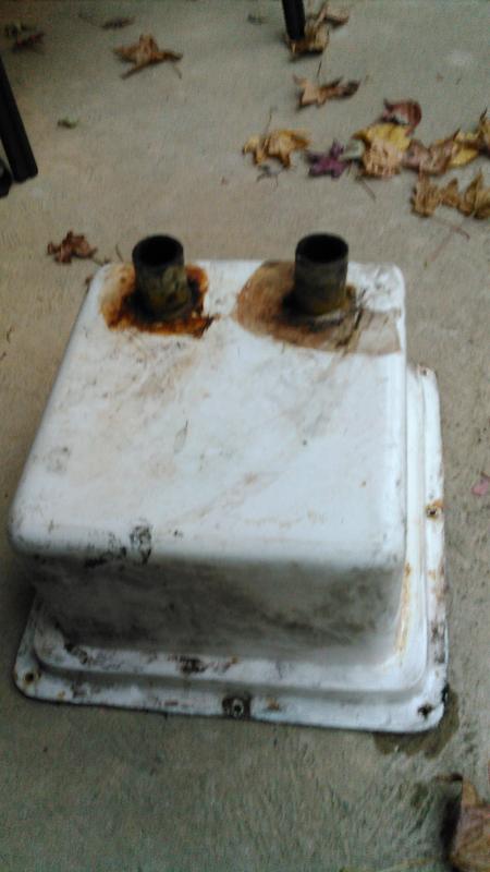

Fred, I took mine off today, Uneventful 15 minutes worth of work... however I had 7 screws not four as you stated.
Could you have missed some:
4 corners and the middle of 3 sides (no middle screw on aft side)
My Catalina is a 1994 C-30. It was leaking at seam around screws. I don't feel comfortable about repairing, I am going to replace the unit with a new one

New Aqualift Muffler from Catalina Yachts $400....They were very helpful ...about two weeks for delivery
