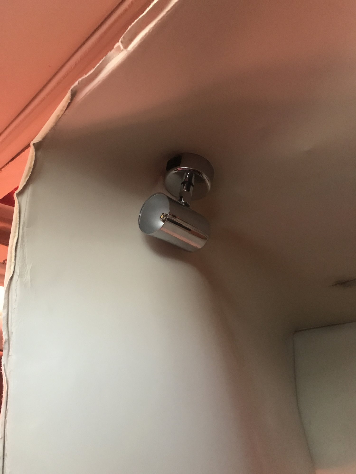

I want to replace several of the ceiling mounted swiveling lights that don't get used, with 12v fans that are sorely needed.
I'm not talking about the flush mounted "dome" lamps, but the silver metal swiveling reading lamps.

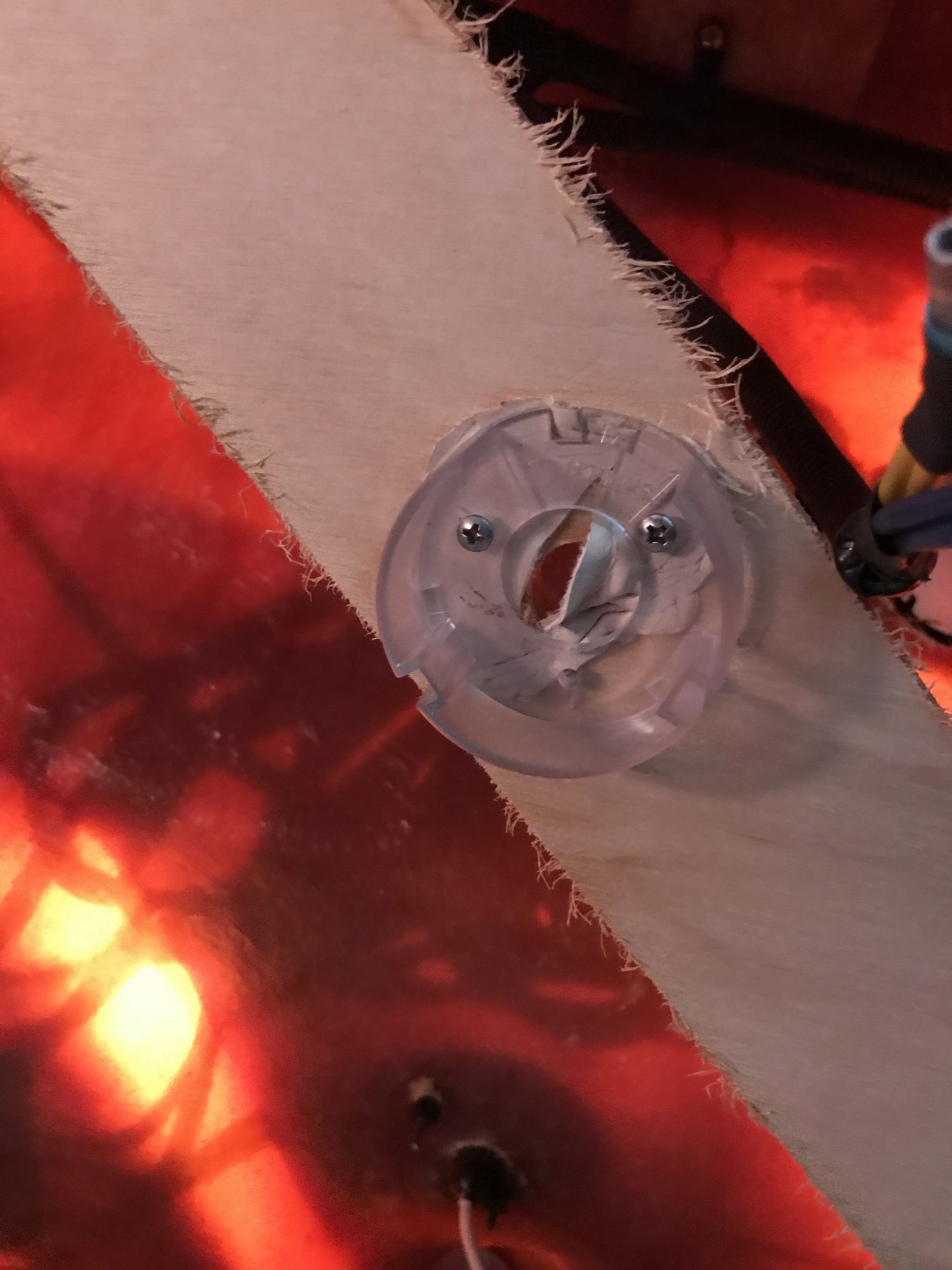

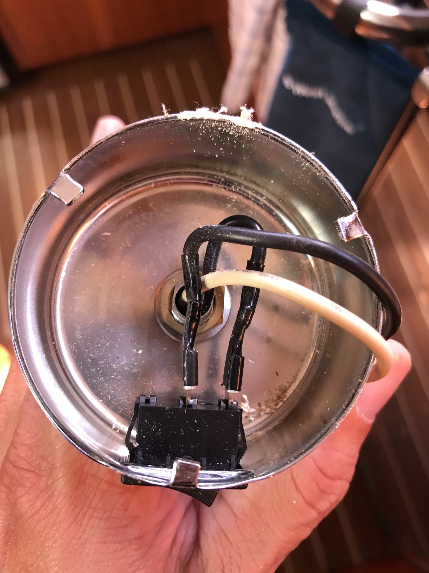

Should be straight forward. The only question would be how much vibration the fan would create. There is a quarter-inch plywood backer behind these lights. There are cutouts in the plywood. It is not one solid piece. The lights twist off and have a plastic bracket screwed to the backer board. The wiring has crimp on bullet connectors so it would be easy to swap the light for the fan. Pic below is what you will find behind the light and headliner. These were taken when replacing the headliner material.
