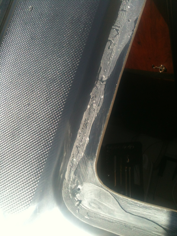

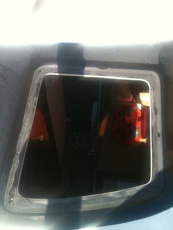

I have a problem with small amounts of rain water getting into my 2006 Mac 26m. I removed the screws retaining one of the side windows and applied some force to try to remove it. It didn't show any sign of moving. I gave up before I broke something. So now I'm wondering if there is a correct technique for removing a window?
DarylA
Mar 23, 2012
61
I had some success today and removed the port deck window... This was also leaking.
It already appeared to be sealed with silicone gasket sealant.
So I cleaned off the old sealant & re-fitted it using black RTV sealant. So now all I have to do is wait till it rains ;) living in England I don't think that will be too long!

Easy way to remove glued in ports is with a piano string and two wood handles.
Just slip the wire under and saw back and forth.
