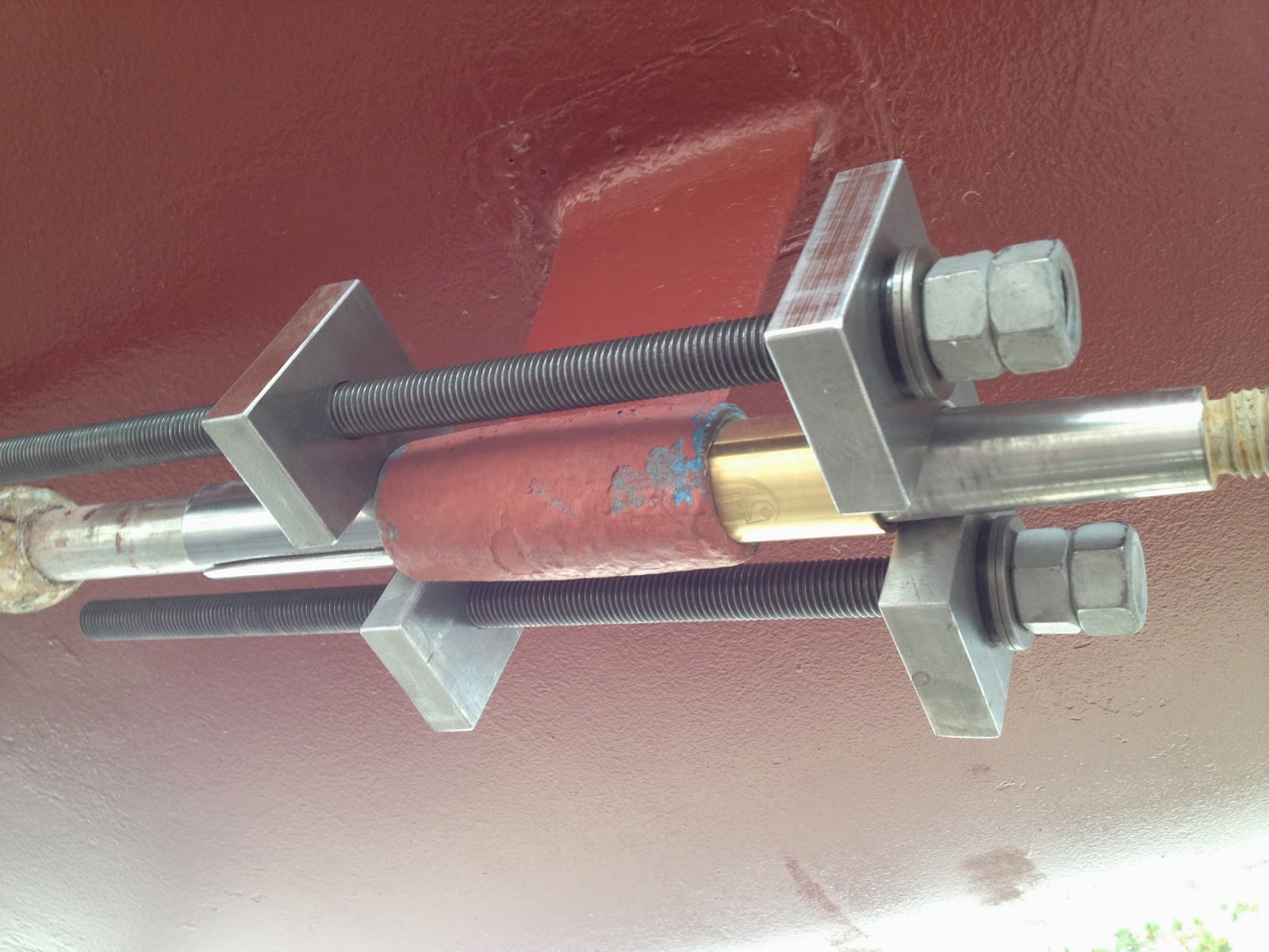

I am trying to think how this could be possible to remove the cutlass without removing the shaft first. If you remove the shaft then the stuffing box would have to be plugged somehow to avoid flooding. If you leave the shaft in then I would think a very special long sleeve would have to be made that slides over the shaft but has an OD slightly smaller than the cutlass OD. And then drive the cutlass forward out of the strut. The old cutlass would have to be cut in half underwater to remove. Maybe there is a tool that does this but I bet it cost more than a haul out.

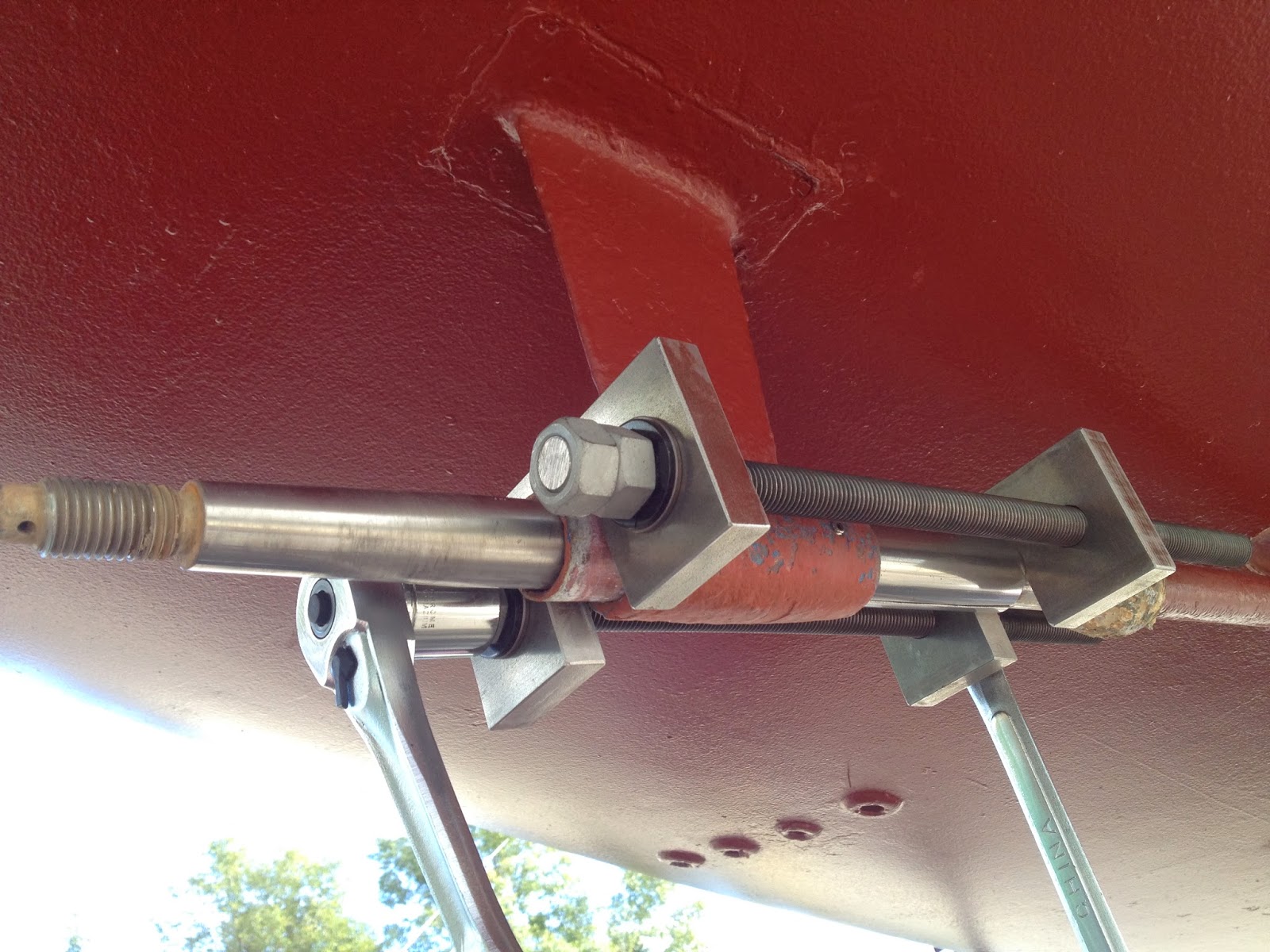

I was thinking the same Concept, But drive the cutlass rearward off the shaft.
This thread was very helpful Cutlass Bearing

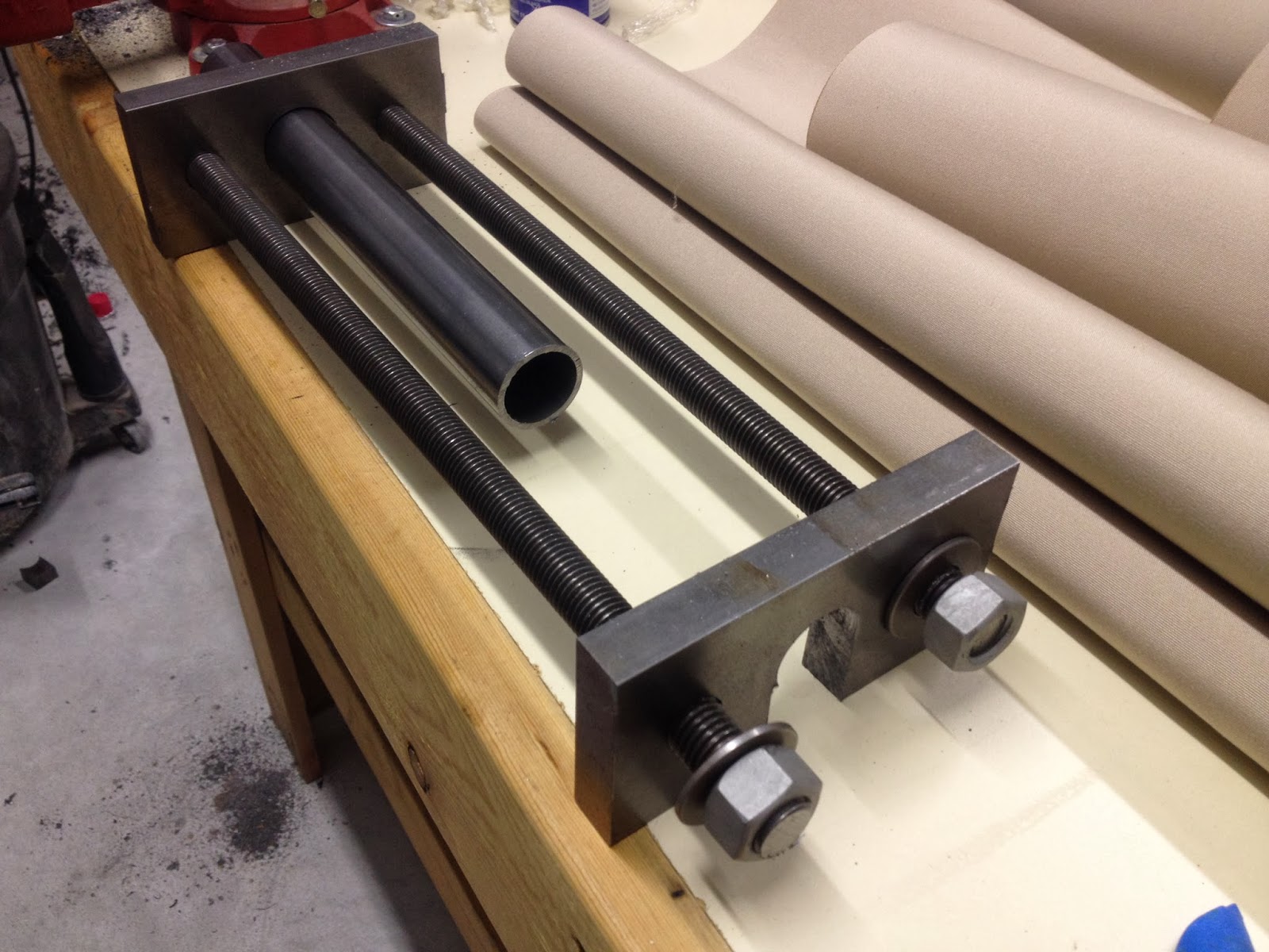

Maybe something of a cross between this:
And this:
Or something like the attached PDF.
All of these were found on this site thank you.
My question is will this work underwater?

I was right, there is a tool to do it :) The tool I made is a long 3/4" bolt with sleeves on both ends and a nut. Shaft has to be out though. No reason why the tool in the pics couldn't work under water....just so it's stainless and use a cheap Harbor Freight ratchet. Getting the correct measurements underwater for your tool may be a challenge too.
