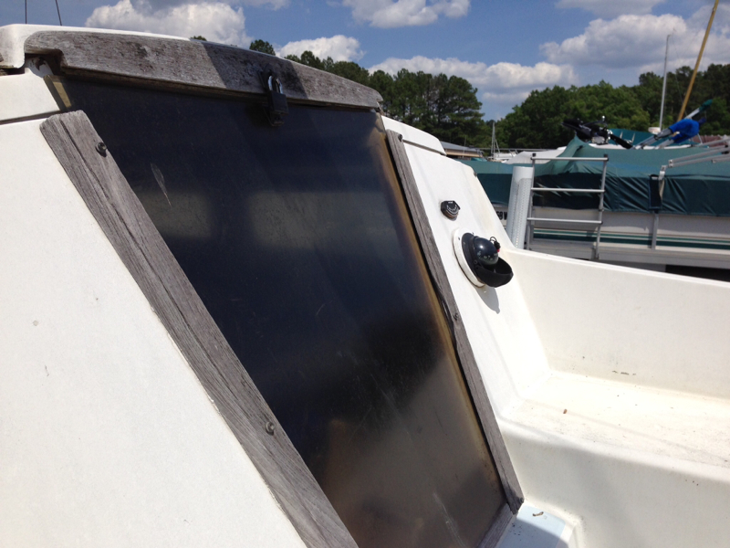

Here's a pic of my attempt to adapt a compass that didn't fit (hole in bulkhead bigger than what was required). I've considered simply mounting a "plastic board" that would cover the hole. However, I hope that maybe there are some other, more creative, ideas out there.

I have 2 big holes I need to plug on my H30. I plan on using white starboard. I'll cut it round maybe 3/4" oversize and rout the outside edge with a quarter round bit. I'll rout the flip side to perfectly match the hole to a depth that will be even with the cabin liner inside. Probably mount it with 5200.

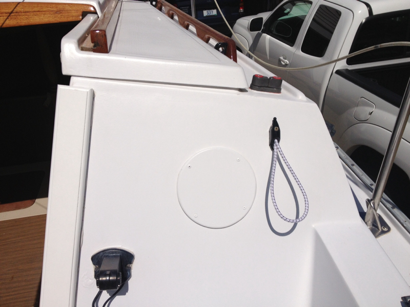

I had the same issue. I simply cut a piece of plexiglas, painted it white, and mounted it over the opening using the same holes from the compass. I used 4200 to seal it.

Use a cheap Malwart cutting board for the circle. Very easy, and doesn't look too bad. You may find a desirable compass down the road that you want, and you won't have to drill another hole where you patched it..
