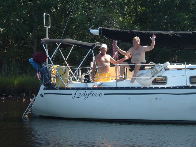

Most non-custom biminis are made with 7/8" aluminum. So long as you get one large enough and with good Sunbrella you should be fine. You can easily cut the tubing to fit. I made my bimini from a Sailrite kit with 7/8" aluminum. Eleven years later the frame and cover are fine.

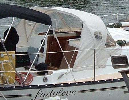

My dodger is the original that came with the boat, an Island Nautical. They have the patterns for our boats. Entry/exit is not a problem but then mine is smaller than yours would be. My '79 has the mainsheet in the cockpit so the the dodger has to be short. I don't like a dodger and only use it when conditions are bad. Otherwise I would have a new one that matches all the other canvas.
Pictured: my crew on the way to Florida in Dismal Swamp with dodger in normal folded down position. A rare picture with dodger up. Must have rained.

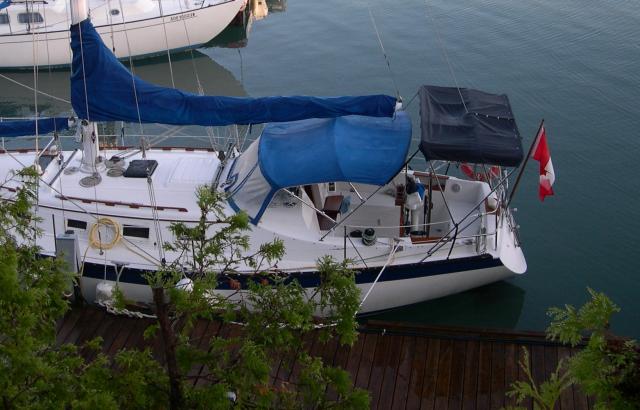

IMHO, you should look around at other boats and decide together what you want, not copy Ed's or ours. We have a tall bimini ( i'm 6-2) with a tall dodger in front and a transition panel that is only zipped in when we are not sailing. We plan to head north next spring and are looking into adding side and back curtains. Ours was custom made with 7/8" ss tubing
1,085

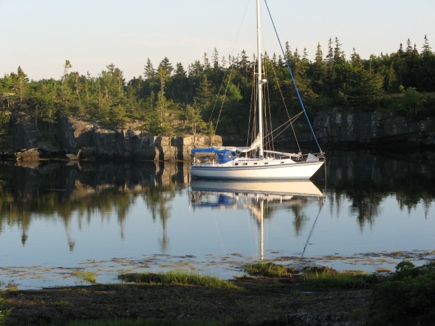

Hi there...and welcome!
Our 1983 H37C has both dodger and bimini. We also have a zip-in transition piece that joins the two together and 4 side curtains that can be attached to enclose the entire cockpit. Unlike Ed S, we almost always have the dodger up and use the bimini less frequently up here in blustery and cool Nova Scotia. If we are cruising and it rains, we often use the bimini and side curtains - we call it our "poor man's pilothouse". In truth, it can be a bit awkward getting in/out of the cockpit when all this is in place. No problem with just the dodger. Dodger and bimini w/o the transition piece and side curtains is OK, but there is a knack to it.
Our boat came from the PO with this arrangement, all made of 'motorboat vinyl' that was white on the outside and blue inside but we recently replaced everything but the side curtains with blue Sunbrella, done by a local sailmaker.

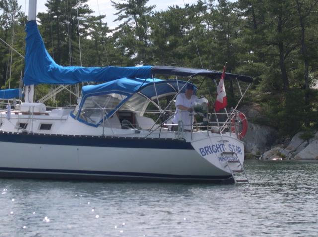

Good discussion. I also have a 1983 37c. I have a huge "Pram" dodger, and on my last trip up to the North Channel I added a 2nd-hand bimini top that I bought off another Hunter owner, and cut down to size. Looks like crap but it did the job.
A previous owner raised the boom 6 inches, and the large dodger is cavernous inside. It also sticks back too far and is hard to get inside, especially with the two side panels attached. Both side panels are now damaged from abuse.
The add-on bimini was also too large, and over-hangs the back of the boat, but boy did it offer good shade. ( See the picture, I'm 5'10" )
My plan is to modify the dodger stainless and reduce the dodger length by about a third, and also make it rigid, and do something similar for the bimini. If I can't get a canvaser to do a custom job I guess I'll have to redo the whole thing. I have cruising plans, not racing, and fair skin, so protection is important.
Also, get the premum plastic window for the front of the dodger, if you can't see over it. The thicker plastic is actually easier to see through.
