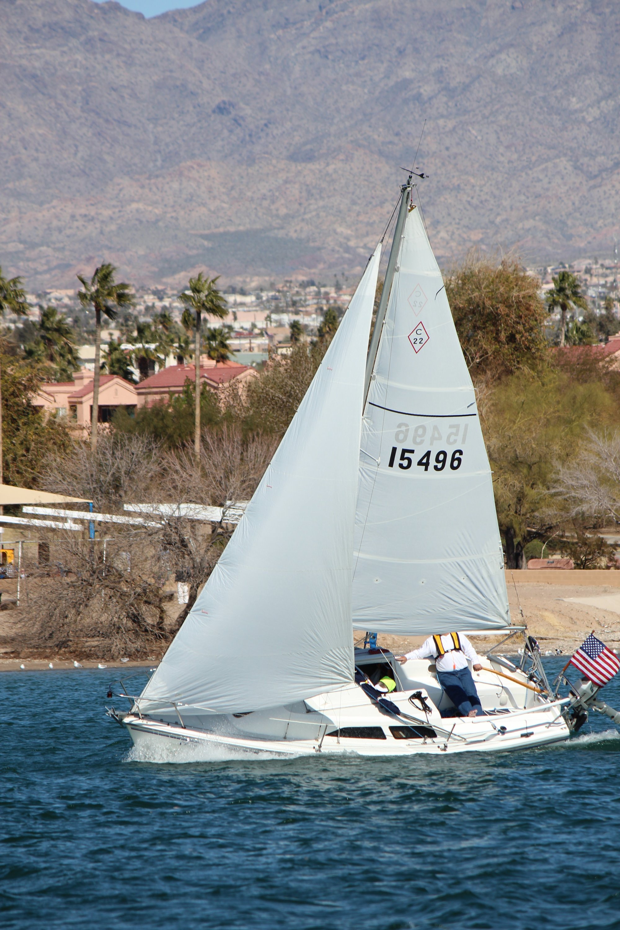

I've only had experience with the Lewmar winches the factory has installed for many years. Always seemed adequate to me. I've sailed larger boats with self tailing winches, and loved them, and I've owned a C-22 with self tailing jib winches, I can tell you first hand, self tailing winches for the jib on a C-22 was not good for me. When a puff hit's, or I need to let the sheet out a little, I can quickly pull the sheet out of the jam cleat and ease out the sheet, or strip the sheet off my standard winch from the opposite side of the cockpit, sorry, can't do that from the opposite side of the cockpit with a self tailing winch, they require someone to physically be at the winch and unwrap it. Now on a new design C-22 there might be a slight argument, but to me, a better approach is the way the factory installed a jam cleat on the side of the cockpit seat back on the older Capri-22's. Here's a photo of my C-22 with self tailing winches. Passed the cool factor with flying colors, flunked the practicality test.

Imagine how much fun it would be having to be at a self-tailing winch in this photo. With my set-up all I have to do is pull the sheet up, and whip it off the drum, all from the windward side.
You're practically beam reaching with your sails close hauled! No wonder you're heeled like that! ;^)

Ward, The C-22 racers typically have a 3" ratcheted turning block where the winch usually was located and route the sheet up to the winch on the opposite side of the cabin top. Photo taken during the 2014 C-22 Nationals in Houston of a C-22 Sport setup for racing.
Rich, the photo was taken at one of the races at the Havasu Pocket Cruiser Convention. Come hell or high water, I was going to make that mark! You can see Debbie looking under the jib checking my status. I had my fixed Rudder-Craft rudder hanging on the transom so the boat wouldn't round up like she would've with a factory rudder.

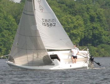

Hey Don...look at me...I want to be just like YOU someday...heeling and fast!
p.s. I'm leading the fleet in this photo...the lens was not wide enough to show them. :)
BTW, winches are Harken 14ST, but I took the ST arm off them.

Yea. Look at the Apparent Wind in that picture vs the sail trim. The sails are trimmed close hauled, but the apparent (windex and flag) show basically a beam reach! Easing the sails to mach would have allowed the boat to fetch the mark and be much faster. Plus you would not have to have a huge handful of tiller to hold the course.
Flat is fast.

Hate to point this out in public Rich, but you needed a 150 genoa to dip your rail in the water. Look closely, I'm flying a jib!
Remember: "It's not what yeah got, it's how yeah use it" LOL
Don
Don...I agree...and also hate to point it out in public, but your Catalina 22 Mk-II w/ Wing is heeling as much with just a jib (due to wing keel), as my Catalina 22 Sport w/ Swing Keel. That makes your boat a lot more tender than mine, and makes my boat faster in higher wind. And I am not one to brag, but my Catalina 22 Sport is extremely well tuned to go fast in heavy wind with very little weather-helm (without a Rudder Craft rudder)...and that's also fast. How's the weather-helm in your picture? (Mine is near-neutral.) Am I going to have to bring my C22 Sport all the way from Indiana to Florida to settle this dispute? :) LOL BTY: we should continue this conversation on another C22 forum thread...we've hi-jacked this thread away from the winch topic.
