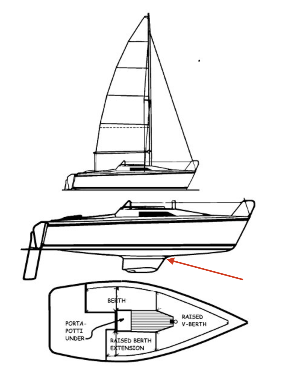

Most likely the leak comes from the connection of the Keel to Fiberglas hull.
Pointed to by the Red Arrow.
Send us pictures of that area and we can better help you.
Jim...

Photos are needed but if water is coming through the keel boats, it sound like the wing bulb keel will need to be removed, caulk removed and cleaned off. 5200 will need to be used vs anything else. For safety , I suggest a marine yard do the work. Former Hunter dealer who sold these boats
