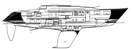

You indicate that your C&C37 was built in 1990.If this is the case, then your underbody would look like this.
This structure shows a strut that would hold the cutlass bearing. That could be removed and reinstalled after removing the propeller. Further, the shaft could be removed and installed without moving the engine if they gave you access to the transmission. Take some pictures and post them here. The engineering for your boat requires a proper cutlass bearing if you want to keep your boat afloat.
