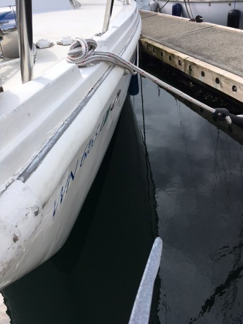

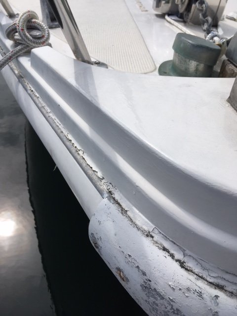

We hit a large wake from a freighter and it loosened the rub rail on our boat, starboard side. Now noticing some bubbles on the port side. Want to make repair but concerned that the way the old Columbia's were designed, we might run into trouble pulling it off due to the double channel aluminum that joins the hull to deck. Does anyone have any thoughts or experience with this?

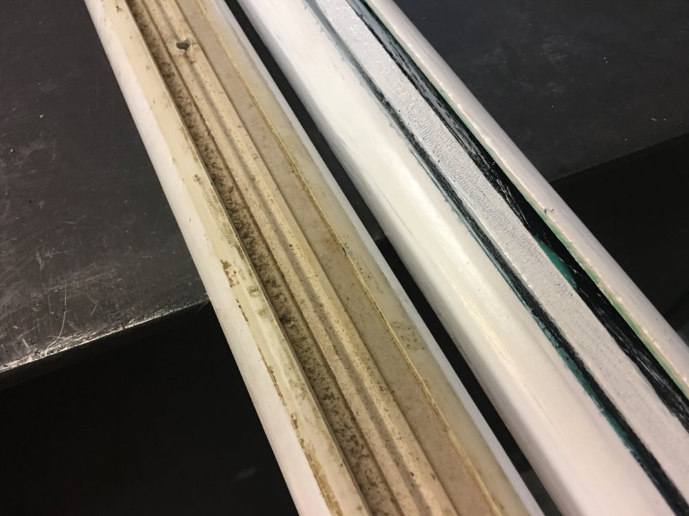

Looking at your rub rail images, it appears there is some sort of caulking applied to the top side of the aluminum fitting. Perhaps to try to stop a leak or perceived leak. Taco Marine, Florida is the primary maker of boat rub rail with a variety of configurations. You’ll need to remove a bit of the rail starting at the end and see what is there. Then look at the Taco Marine’s list to find something that matches.
The aluminum strip is attached to the deck/hull with screws. Some screws may be stripped. That could be a source of leaks.
While doing the work. A great time to inspect the deck to hull joint.
