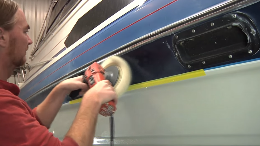

RE; Any brands in particular?
3M has a good reputation.
https://www.3m.com/3M/en_US/marine-u...ishing-system/
Andy at boatworks today.
uses Magiuars
