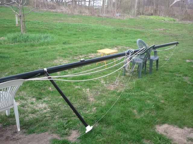

Ok, I'm sure some will point out the error of my ways..but I'm a rookie at this boat restoring hobby and I don't have much cash to throw in that direction. But for less than $10.00 and some elbow grease I painted my mast and spreaders with Rustoleum Professional enamel. Went from a scratched, faded, old mast to a lovely gloss black finish. Masked off all the fittings (didn't have to remove them) and sprayed on two coats. Dries fairly quick and looks great. No cracking or peeling from moving the mast around that I can see. We'll see how long it lasts...but it can't look much worse than it did.
Ended up looking so good I painted the rudder housing as well.
My boat is quite a bit smaller so maybe it's not feasible for you but on my little Starwind 223 it looks pretty decent. I'll try to figure out how to get some pics on here.
Sorry this took so long but here's a pic of the completed mast and spreaders:

If not for the weather interfering I would have completed the mast and spreaders and the rudder housing in a weekend easy. As it was the coats got to set for several days waiting for the temp to come back up and that may have been a good thing. I masked over all the fittings, removed those that were easy and painted the whole thing. 2 cans of Rustoleum Professional laquer for a mast, spreaders, and rudder housing and I still have a bit left over.
