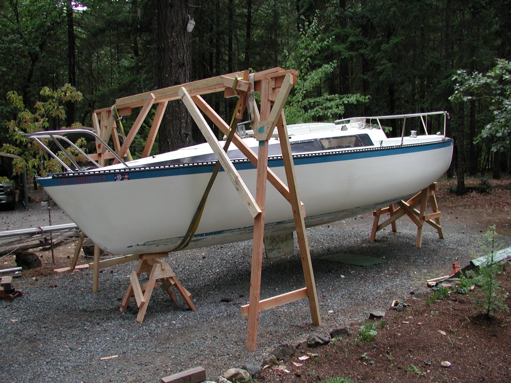

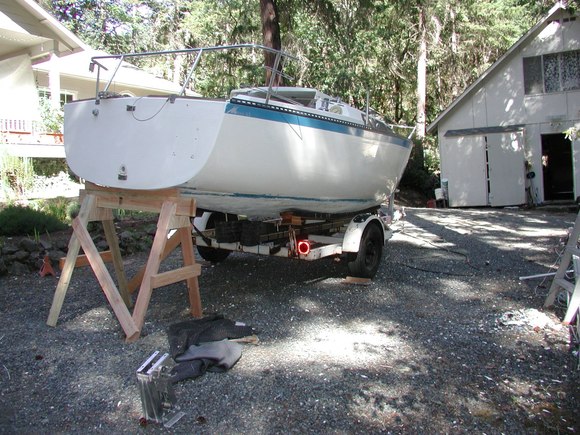

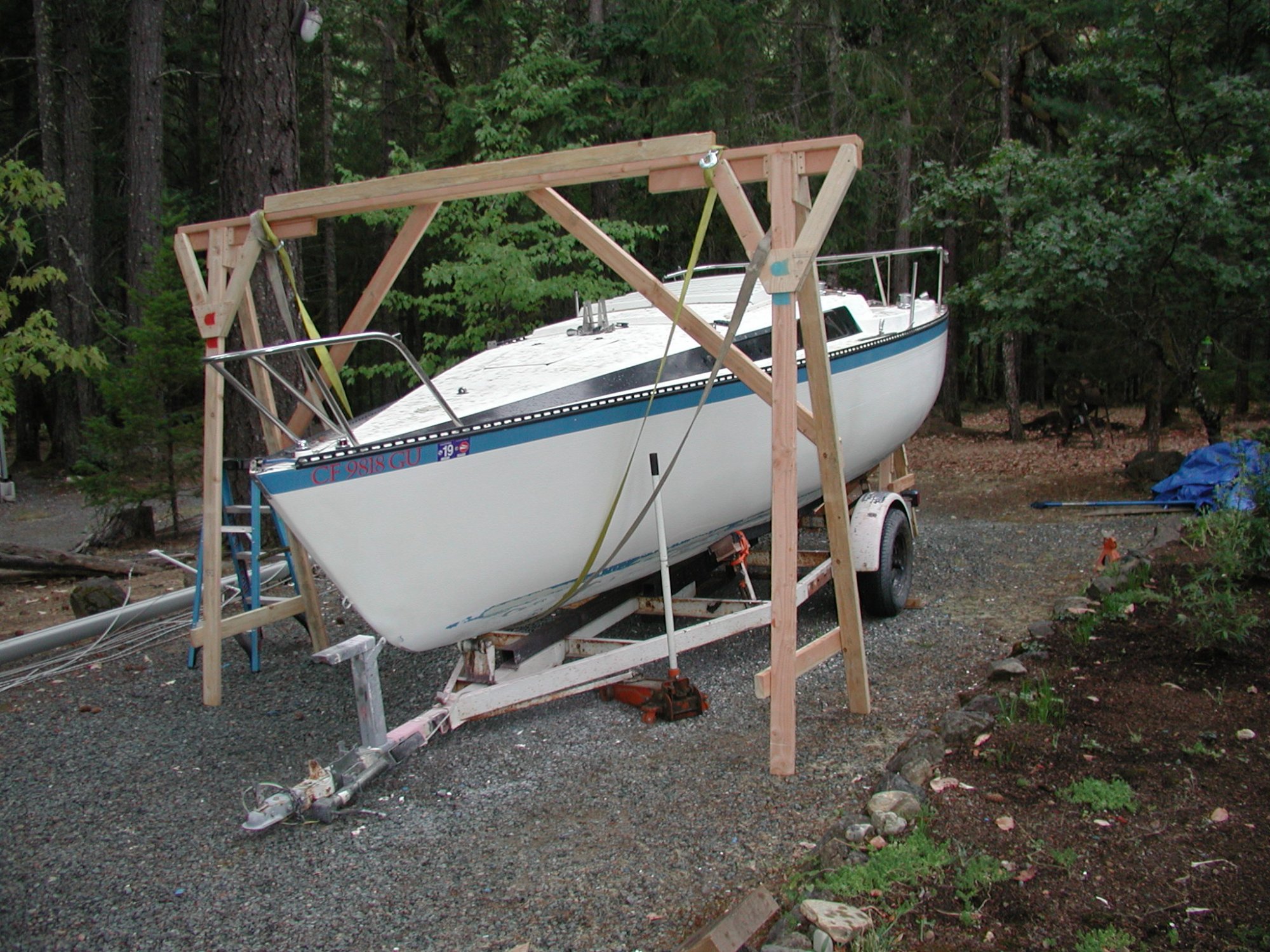

RussC
Sep 11, 2015
1,690
Merit 22- Oregon lakes
lower the tongue of the trailer to the ground
place cribbing under the stearn
raise the tongue of the trailer as high as you can (a floor jack works well) which will get the stern off the trailer
secure the bow to whatever is handy or fabricated with straps
lower jack and pull trailer out from under boat
Likes: Timm R Oday25
