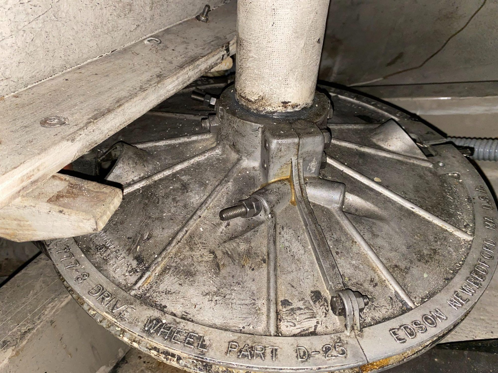

Here is my quadrant :) Looks the same as @dmax posted. Funny thing about the Oday 28 it got all of most of the same parts as the larger Oday's ... that is lucky :)
23,864
Looks good. Might put some Krill oil or PBBlaster on the nuts. Let it soak. Might help to ease their removal.
Apr 25, 2013
86
Oday 28 Toledo Beach
@jssailem Oh good call will do that now... it can sit all night and then haul out is at 2 tomorrow after that we will drop it! Will keep ya posted! Appreciate the help!

Rudder came out super easy! We marked on the quadrant exactly where to re-align it back up in the spring and just loosened the bolts as per @dmax pic showed. The main pin was not hard at all to remove after taking pressure of the rudder.
Doing it hanging in the sling was SO much better then the last time when I had to do the hole digging! I think we had it safely out in about 20 mins. (putting it back in I know is more of a puzzle lol, I totally remember that!) I appreciate all of your help! :)
