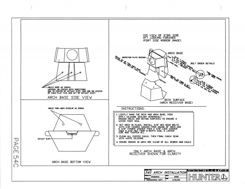

I have a 1998 Hunter 340 with a fiberglass arch and will be moving the boat next week. Does anyone have any advise on how to remove the arch?

From our 99 model owner's manual, see attached
I've never had ours off but I know access to the bolts is from the aft berth and through the speaker holes. The starboard side looks especially difficult to get to, but they shipped them to the dealers without the arch installed

My bolt holes were leaking on port side. Should be a "simple matter" of undoing the bolts and pulling off.
