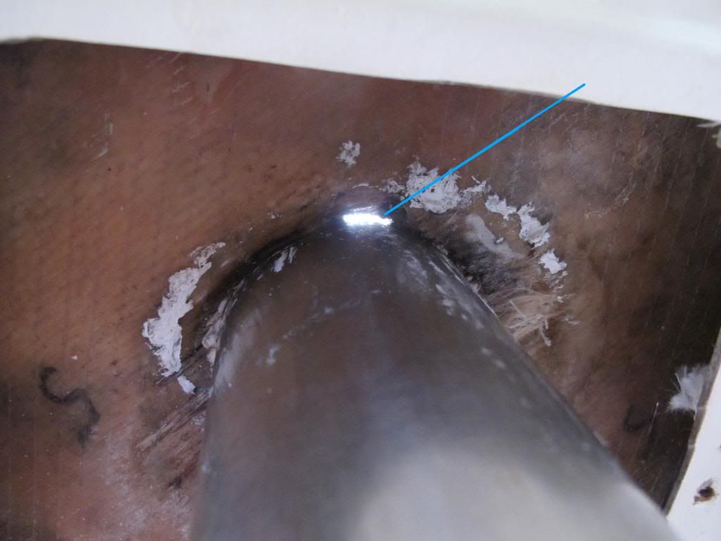

This photo shows the hole into the boat where the water ran down the outside of the compression post.

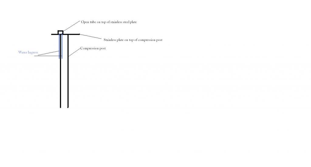

Excuse my crude drawing but this shows where the water was entering inside and outside the compression post.
The question now is whether to remove the compression post or just seal the whole thing properly and live with the fact that the counterbalance weight will be stuck for ever?
There are no visible drain holes from the inside of the mast step but water does drain to the outside around the join with the stainless plate when I cleaned the inside of the mast step.
