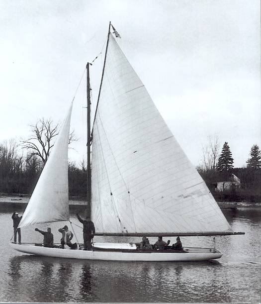

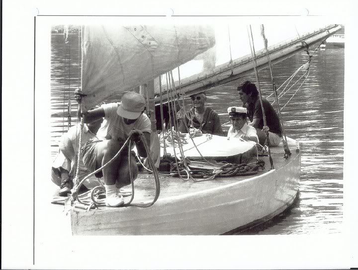

there was a day in which there were no stanchions nor liflines. that is how i learned to sail...
btw--on bottom pic, is me just in front of eleanor's mast--ii have the white scarf....
