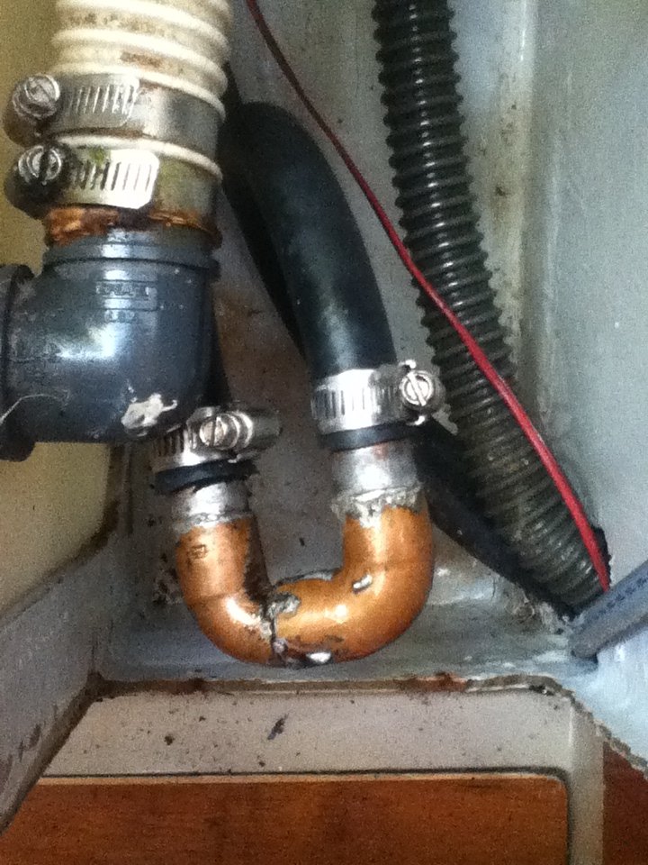

May 16, 2015
104
C&C 37 28127 Port Madison, Washington
Resolved. I even found the fiberglass cutout and taped back in place. I'll be looking for a replacement bus heater down the line.5F1266A8-72C4-4498-AF50-D244542AF36E.jpeg
Apr 5, 2009
3,218
Good job. You will still need to make sure that you get that hose purged. You get air in the line when you open it up and if that gets trapped, you will not get proper cooling.
