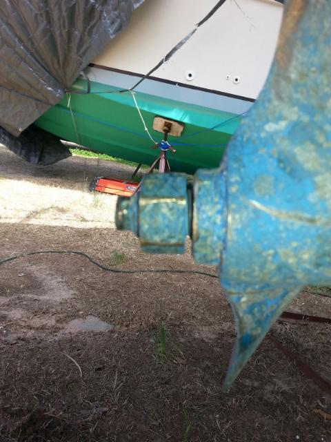

Well, mine has always had the thin one away from the prop. Maybe that's wrong as the thick one could be torqued more to lock the two in place with out over pressing the prop onto the shaft?? From the picture, you can see mine are the same diameter. Maybe someone lost one of yours?

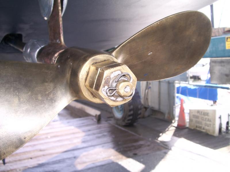

2 nuts are the normal way to install a prop. One nut holds the prop on and a jam nut holds the first nut on. Safety wire or a cotter pin holds the jam nut on.

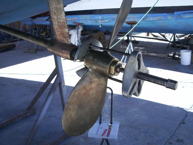

Once the jam nut is off and the prop nut is loose, you need to use a prop puller to loosen the prop. once the prop breaks loose, then remove the nut and propeller. The nut is left on while the prop puller is used to keep it from becoming a projectile when it pops loose.
