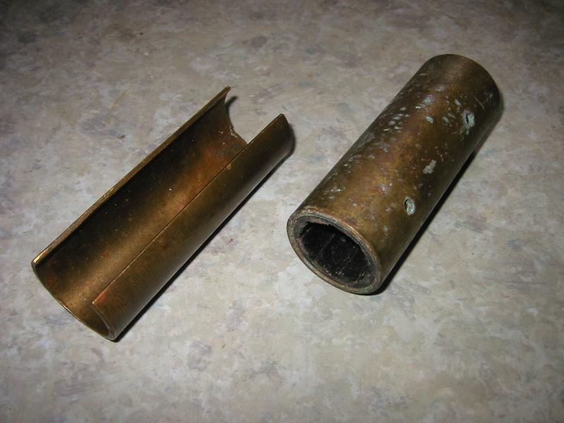

Your boat would appear to be old enough not to have one of the thin walled SRBP cutlesses but to have a nice sturdy 1/8" thick wall bearing.
I ferreted around and found an old cutless of the same size (2" OD 1" bore 4" long). Then I hacksawed a 1" wide piece out of it as per the attached photo. I gently squeezed it in a vice to very slightly reduce its diameter.
Next I took the prop off.
Then it was only a matter of digging away the antifouling over the two grub screws holding the worn one in the 'P' bracket and slipping the cut old one on to the shaft and simply laying the head of a hammer on the shaft and sliding it down to strike the bearing. The bearing came out easily enough without needing to apply too much weight to the hammer blows. If it had resisted me the I would have held a weight against the strut to absorb the blows.
