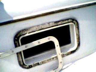

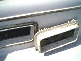

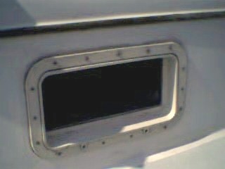

There were/are two types of Gray portlights. They are the same inside, they screw through the fiberglass and into the coring of the cabin sides. The spigot or frame goes through the hole. Then the outside trim ring goes around that. My Grays were the type that had screws securing the outside trim ring. Many were just held on with the adhesive of the caulk. Originally that was silicone. If you check Hunter Owners Mods under Boat Info, especially for the H37C, you will find several photo projects of Gray portlight repair or replace. Here are a couple of pictures.

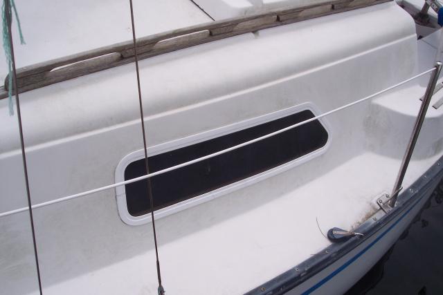

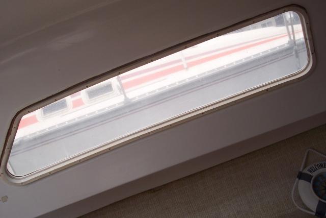

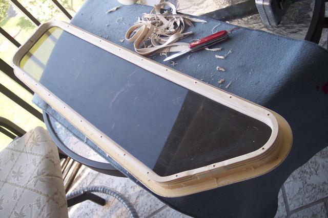

Sorry for not being more explicit with my original post. Ed, your assumptions are right, it is a hunter/cherubini. A 25ft, 1979 model fixed keel. Draws just about 3 feet which is ideal here. The channel to the Gulf gets down less than 4 ft at low tide and the bigger boats have a small window to sail in.
Anyway, I have had this boat for about 2 years and discovered this leak yesterday while cleaning the interior.
I attached a couple of pictures of the offending portlight. It doesnt open. Its about 30 inches long, squared off at the front and angled at the rear. The exterior flange is fairly light weight. The sealer that I can access from the inside still seems quite flexible. I didnt find any that had hardened. I am mostly concerned that I dont damage it so i can get a good seal on it when I re-install it.
Any help is appreciated.
Thanks
Rick G

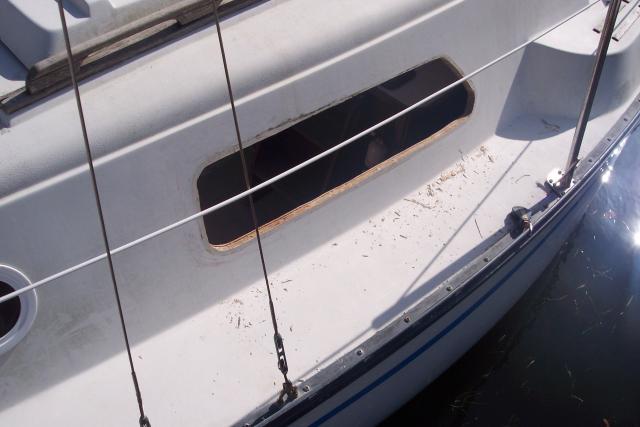

SUCCESS! The leak has been repaired
I managed to get the port out with, cleaned, and reinstalled without destroying it. The primary tool was the red knife you see in the attached picture. Carefully worked it around the outside under the lip. Then after removing the inside retainer, I had to cut away the adhesive between the frame of the port and the deck. Just took some perseverance but the leak is gone. Thanks All.
