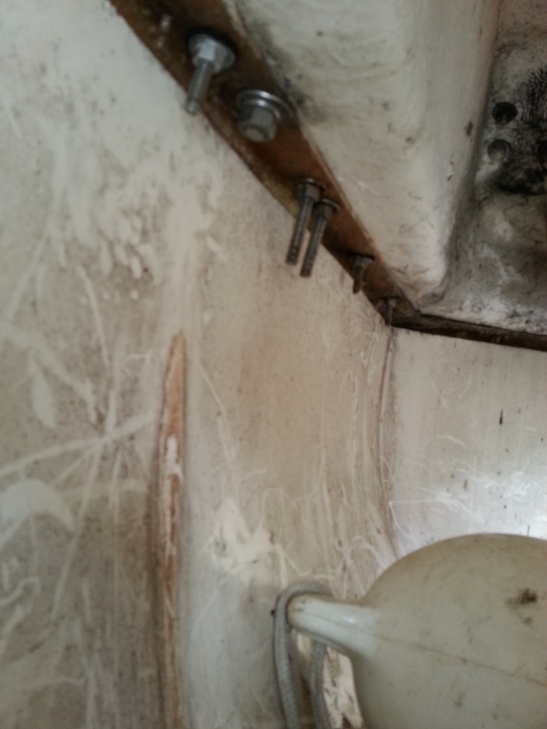

Some of mine have a nut welded into the base and then a bolt & washer run up from inside the cabin. They were a little difficult to tell apart from the deck joint bolts, they are not the same size and are farther outboard and were that much more of a hassle to get to.
2015-12-13 13.51.35.jpg Don't know if the photo helps at all (it's all I have) , it's the starboard stern quarter from underneath. From the left the first bolt is the toe rail, the second shorter one is the first stern pushpit rail bolt, the double ones are for the backstay and the last two are for the toe rails. (Picture was taken in the process of tightening the toe rail, etc. to get rid of leaks)
