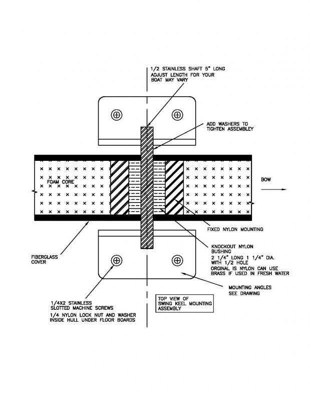

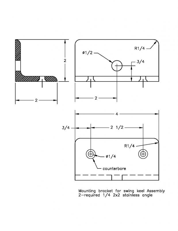

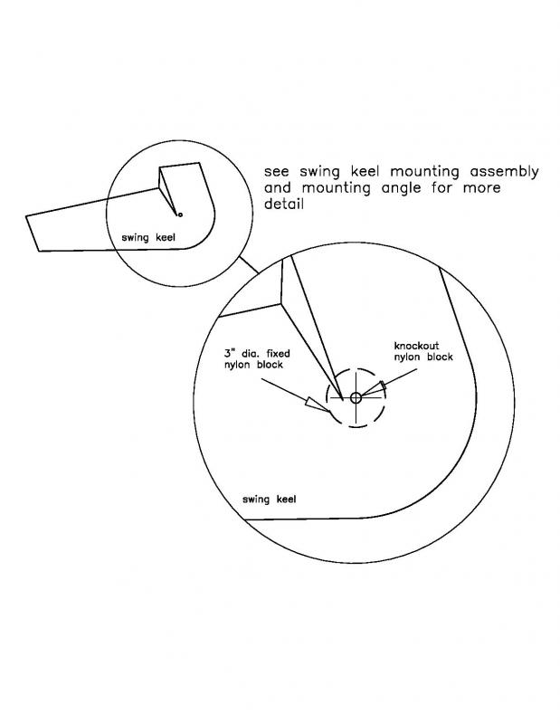

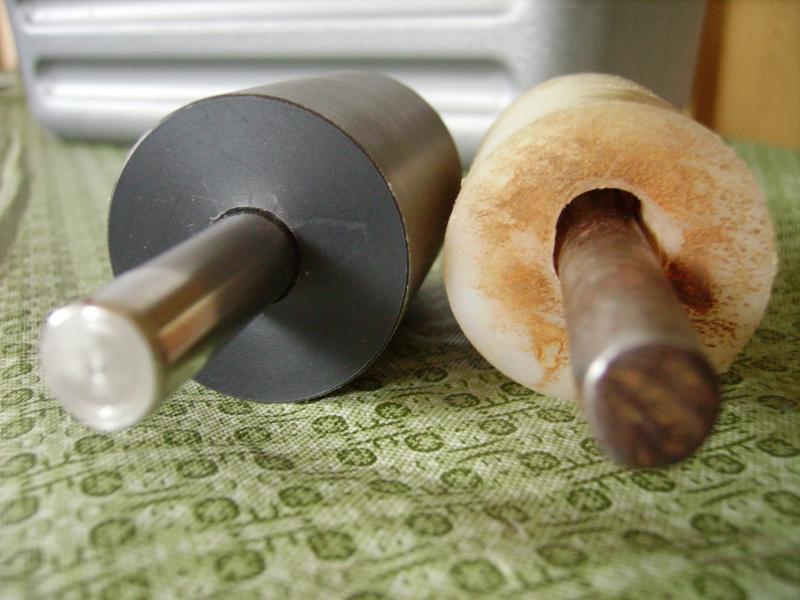

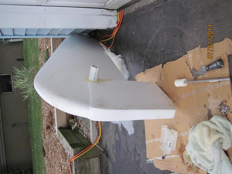

Two years ago I replaced my bushing with solid nylon round stock from an outfit in New Jersey drilled to accept a 1/2" stainless steel rod that I bought from a hardware store, both cut to length to fit. This year I repeated that process for my NEW swing keel (previously repaired keel failed) from Foss Foam as all they provided was the moulded keel. A couple of hole saw cuts later...I'm back on the water sailing .. still .. even after we just picked up 1-8" of snow here in Connecticut and 3/4 of the state is without power.. Long Island Sound water temp is still 58'F. (sorry, I got a bit mistracked there)

OBTW---You need to clear ~32" from the ground to the bottom of the boat to drop the swing keel while on the trailer. Also, see my new keel and nylon/stainless steel rod pix attached.

Nice video. Installing it shouldn't be a problem then.
Yeah the most common problem with the keel is the bushing gets worn down, and becomes oval like that. Then it gets sloppy side to side.
Like I mentioned earlier, I replaced mine (well actually replaced the whole keel, but thats another story), with a bronze bushing, and new SS pin, and new SS mounting brackets. When Foss Foam (OEM of the keel) made my new keel, they install a delrin (sp?) bushing. I sent them my bronze bushing, and they installed it during fabrication.
