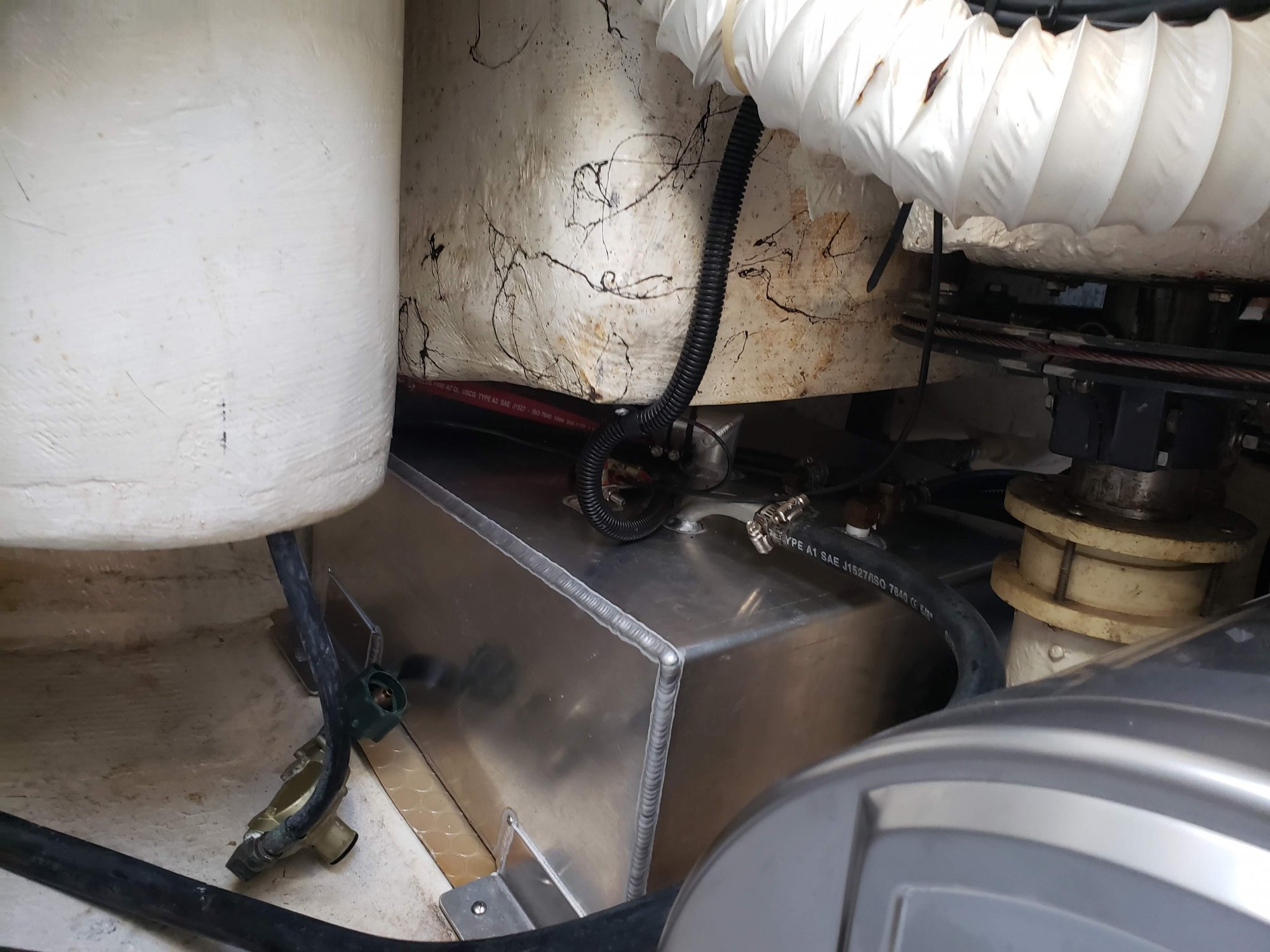

Buried behind a webasto heater, the autopilot arm and its associated bracing, and I think prohibited from removal without first extracting the water heater, my fuel tank either has a leak or hoses I cannot see or access are loose causing weeping fuel in the bilge when the tank is full. Advice on how to inspect and if needed, remove the tank is appreciated. Feedback and advice is appreciated.

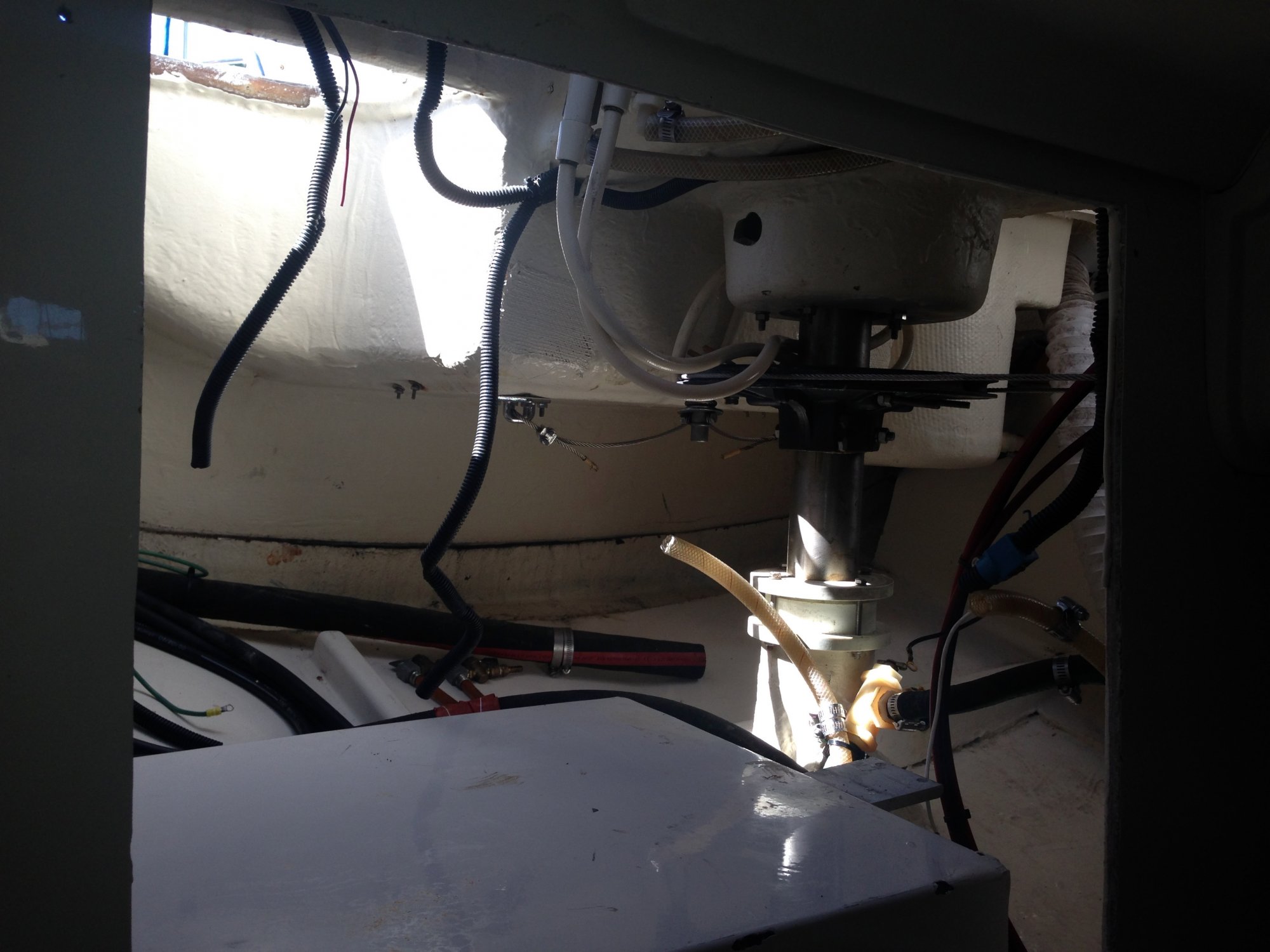

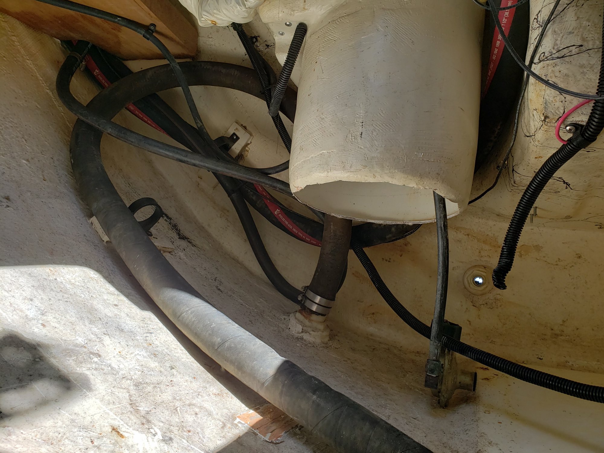

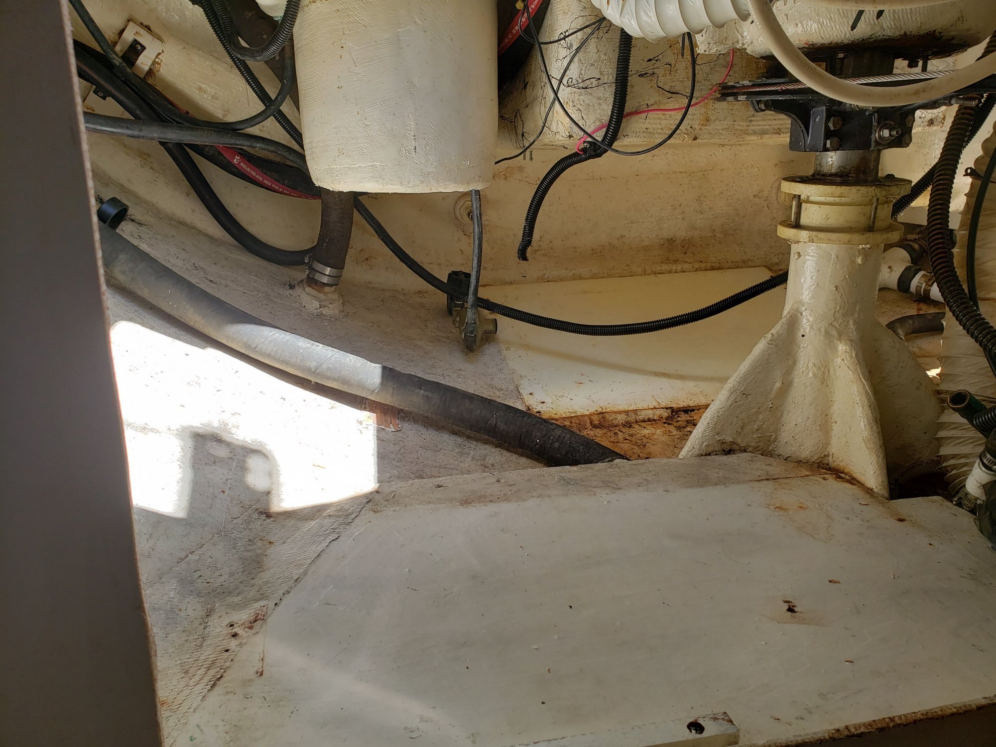

We went through this fun exercise in 2020 when our fuel tank sprang a leak in the middle of a months long cruise in Florida. It was a pinhole at one of the weld spots at the bottom edge and a bilge full of diesel was our first and only hint. Veey hard to access and even confirm the leak-make sure you use a white cloth like a paper towel because myleak looked like water until i saw the red color on the paper towel. We did a temporary repairwith JB Weld which got us home to GA. Once home i hired a professional to do the replacement although i was next to him the whole time. Attached are some pictures and itis very difficult to access but removing the monstrous, factory installed 20 gallon water heater really opened up the stern area. Even with that, the fuel tank would not come out without cutting off the bottom of the propane locker (see pics). Removed the old tank which was held in place by 8 screws and had an identical replacement fabricated locally. While doi g this we replaced the water heater with a new 6 gallon version which is more than enough and really opens up the lazarette for storage. The tank we pulled out stated it was 17 gallons (specs say 20) and i was hoping to get 20 gallons into the replacement but alas when i filled it 16 gallons was all it took. The propane locker bottom was fiberglassed back on and we were back in business. It was a very expensive projectb but had to be done. New fuel guage sender and new fuel guage does not work very well which is a dissappointment. When full it reads between 1/2 and 3/4 but i am slowly figuring out how it relates to what isin the tank. When first installed the sender leaked like crazy but using liquid gasket material around it has eliminated the leakage. Hope this helps and i wish you luck and maybe it is just a hose... Last picture attached is the new tank.

There is no need to cut anything. The propane bottle holder is easily removed. There are four screws and some sealant holding it in place.
The tank can be removed after removing the hot water heater. It is tight and the fittings on top of the tank also need to be removed for clearance.
The tank can be removed after removing the hot water heater. It is tight and the fittings on top of the tank also need to be removed for clearance.View attachment 202278View attachment 202278
This is correct but we were unable to remove the propane holder. After removing the screws the sealant used around the holder would not budge and we were very afraid of damaging it beyond repair. At that point it was easier to cut and repair. You do make a great point that i had forgotten about!
