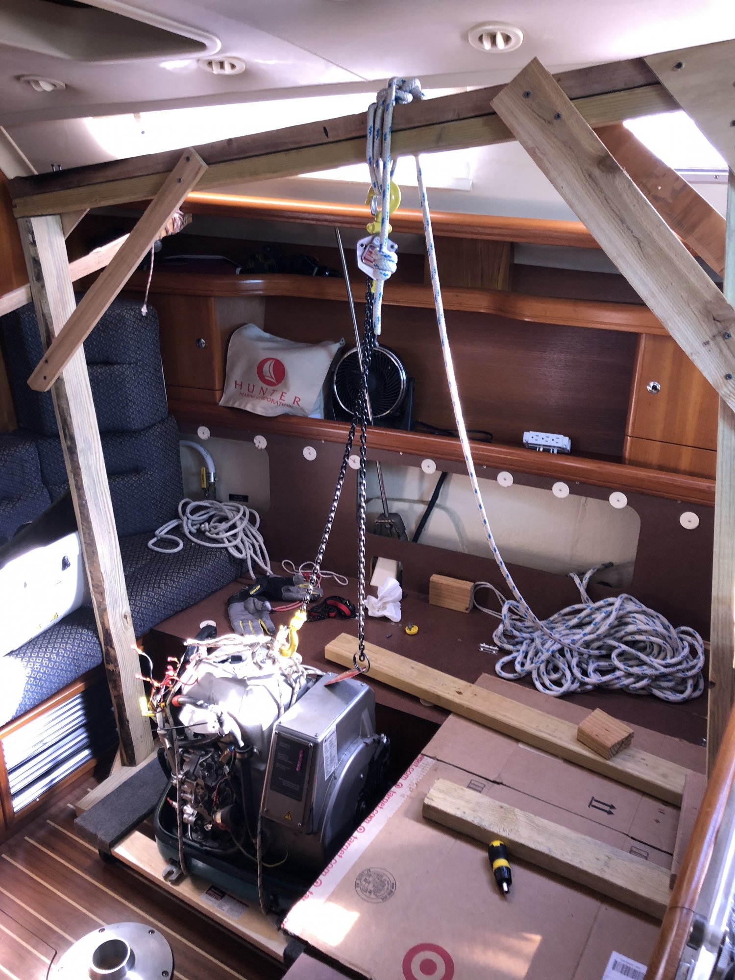

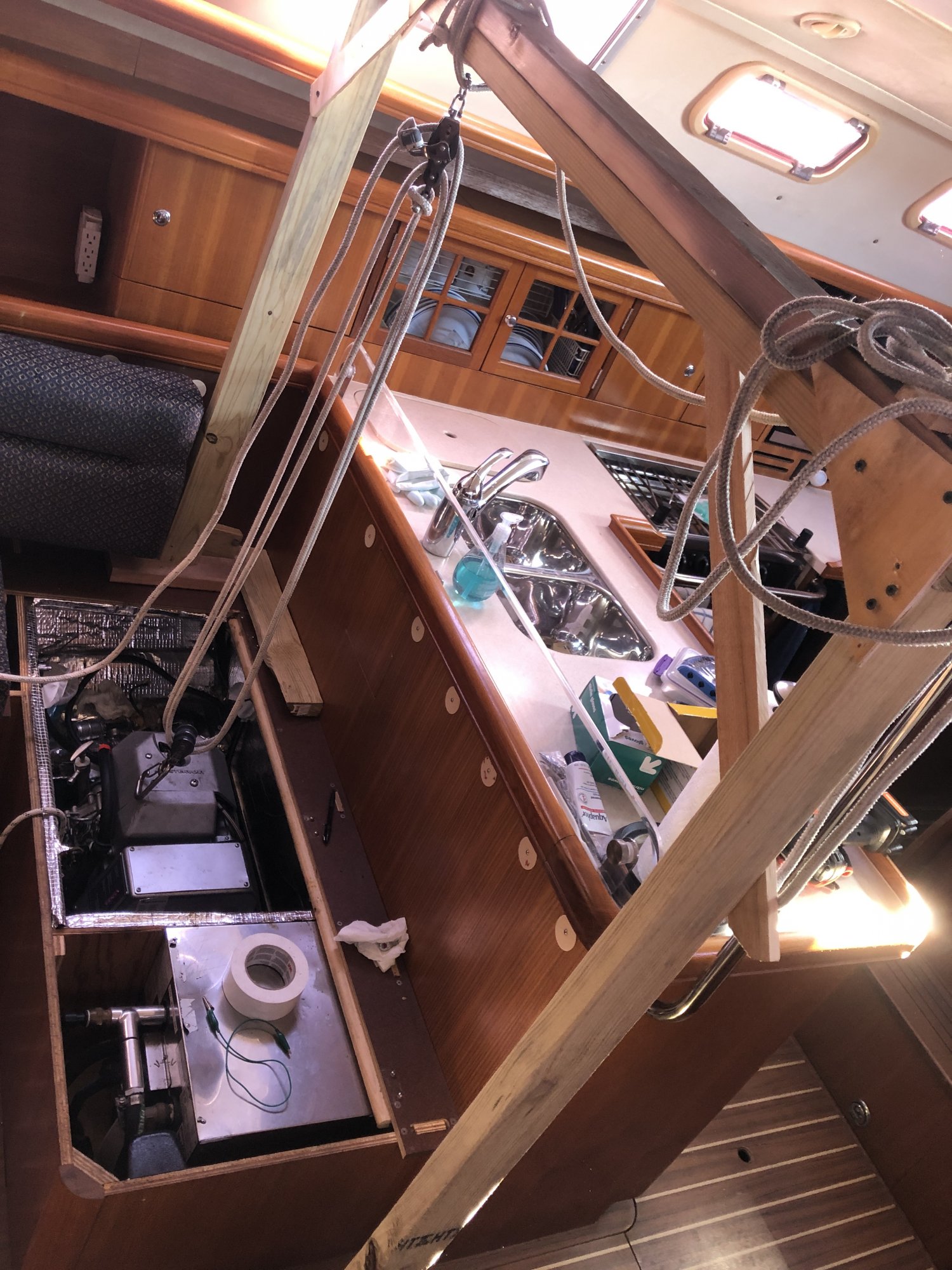

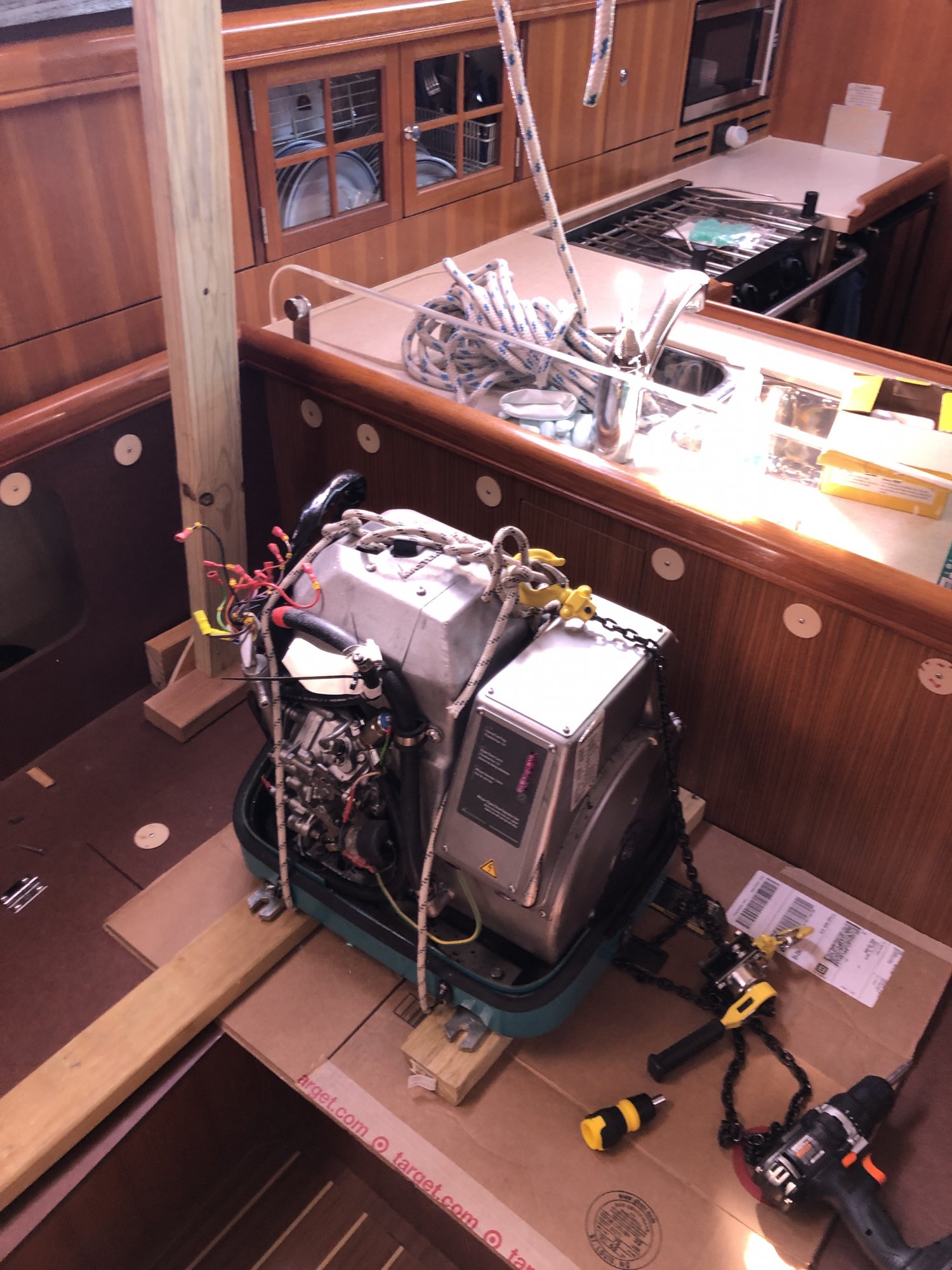

Pictures would help. The genset should have a lift point (a ring?) on top that can carry the weight of the unit. If not, use rope to build a cradle around the unit. Get a ratcheting chain hoist (Harbor Freight has several models) and set up some temporary scaffolds. Get a furniture dolly to make moving the set to the companionway easier. Once under the companionway, use the boom to lift the genset topside. Support the boom with a halyard or topping lift close by the lifting point. The boom can also be used to swing the genset to the dock once clear of the companion way. I hauled the genset out of a Hunter 38 using this method. Use lots of cardboard and 1/8" plywood to protect the finish on the interior woodwork. The first few pictures show the scaffold and blocks and tackle. The block and tackle was not effective, so I switched to a chain hoist. Think it through and it's not a difficult job. Just be methodical.

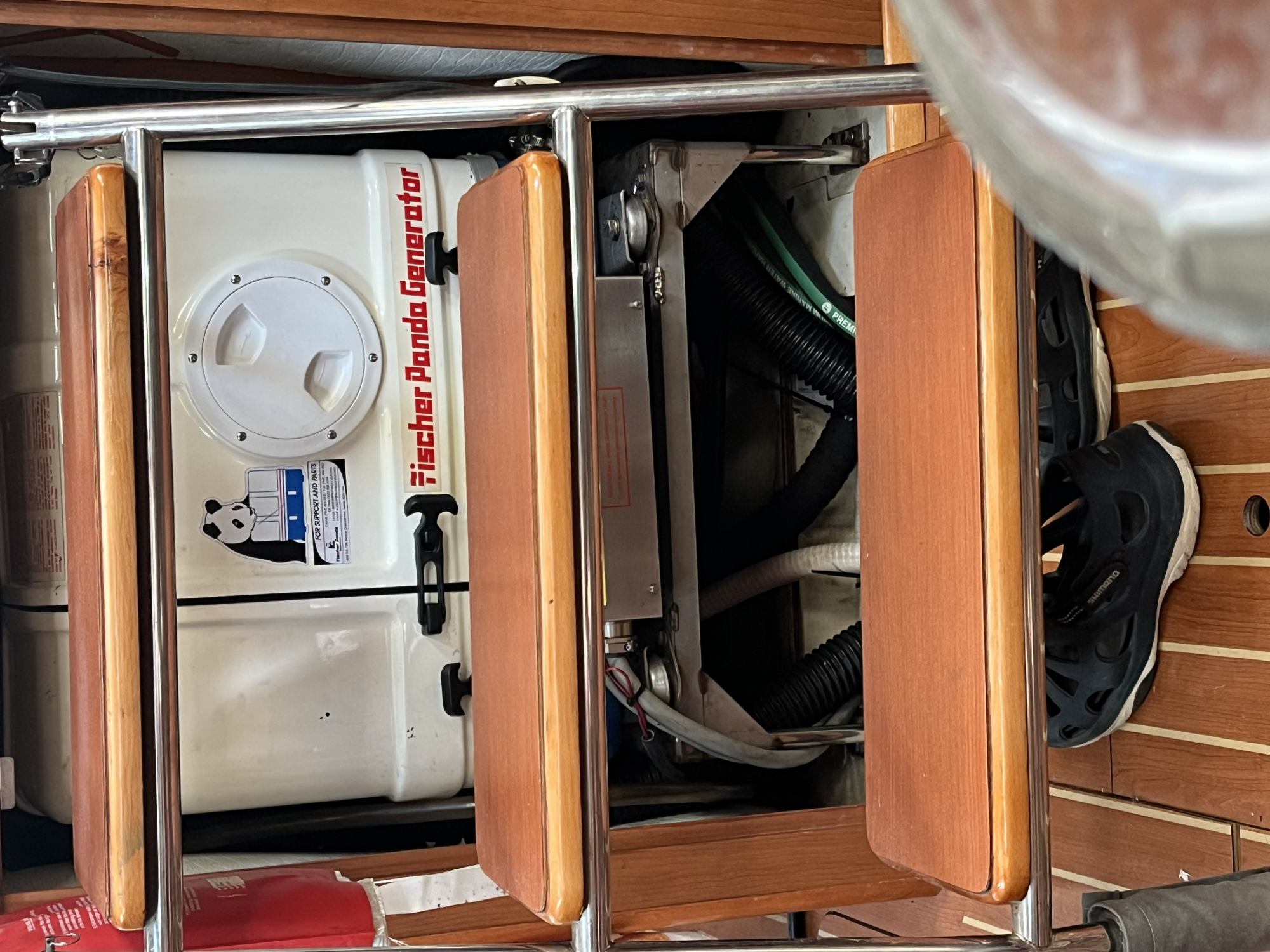

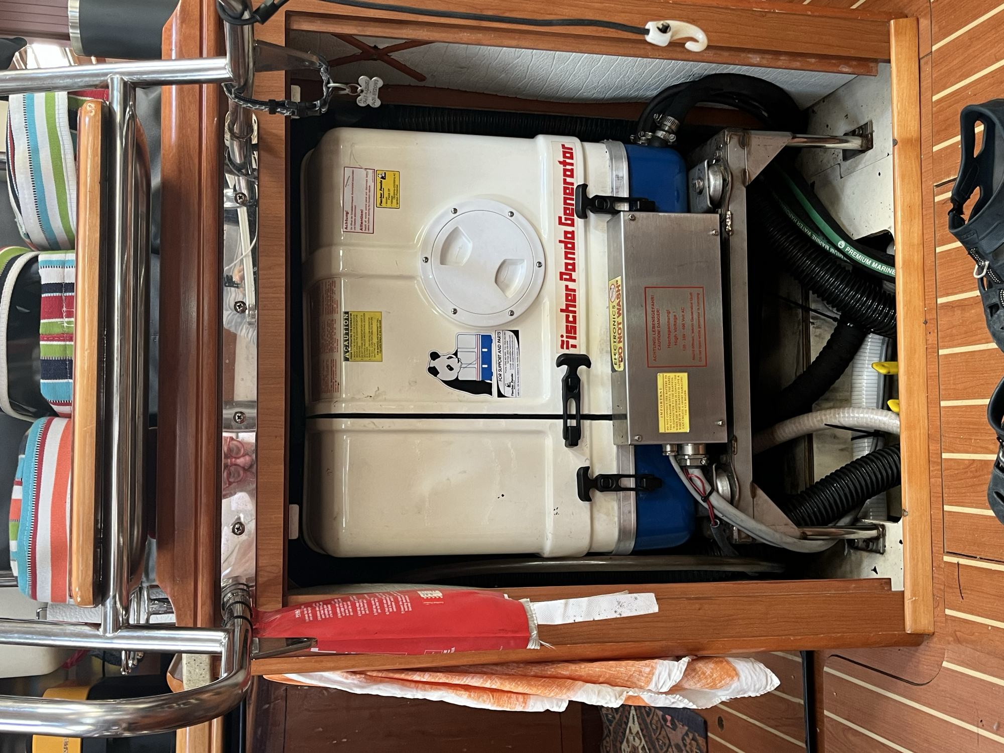

Thanks for your replies. Here are a couple of pictures. You will see that the genset is installed (it is a Hunter factory install) under the companionway. So it is not just a case of lifting it up, it has to come forward about 70cm first. Are there no other 45CC owners out there who have done this?

I have the same boat and did remove the generator. It was actually not that hard. Unbolt the generator and leave the frame attached to deck. I built a table that was the same height as the generator and with 2 people slide the generator on top of the table until it would clear the companionway and then you can either use the boom to lift or in my case I had a crane take it all the way out. I had many problems with the generator and did not replace it. I purchased a new Nex Gen 5.5 and am very happy.
