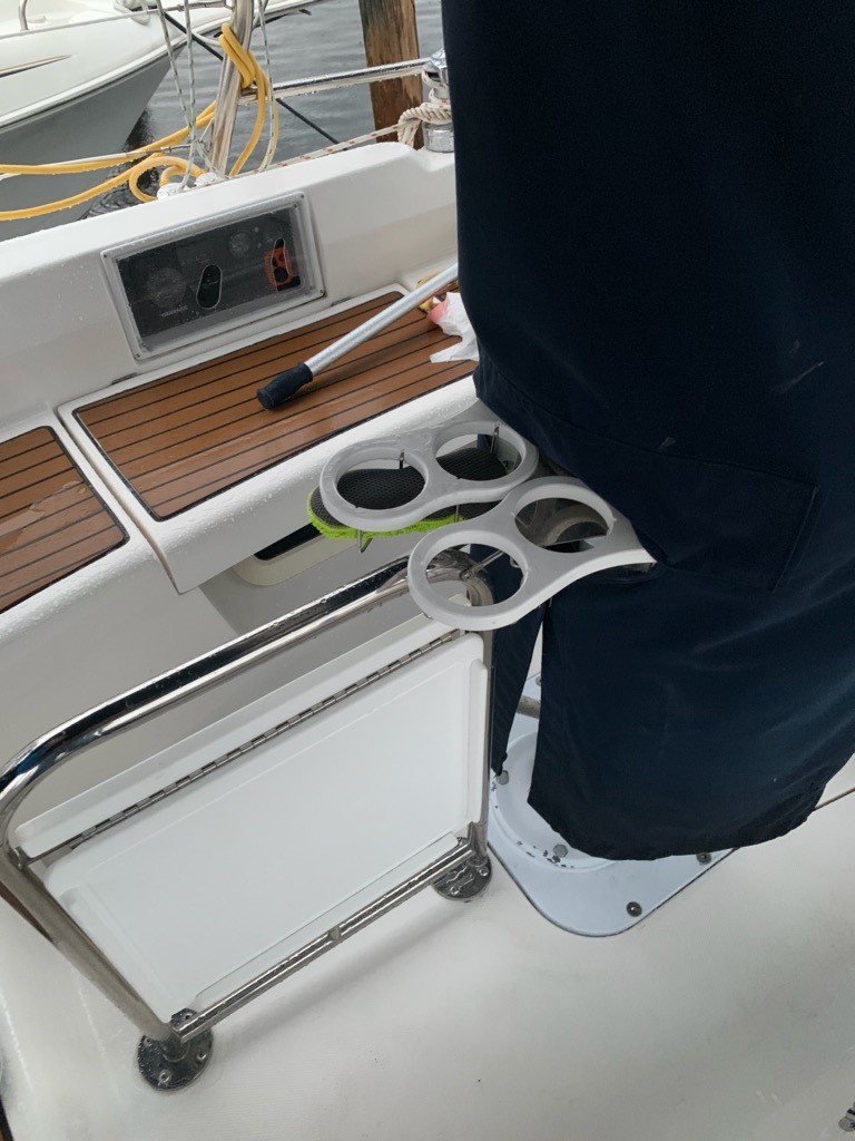

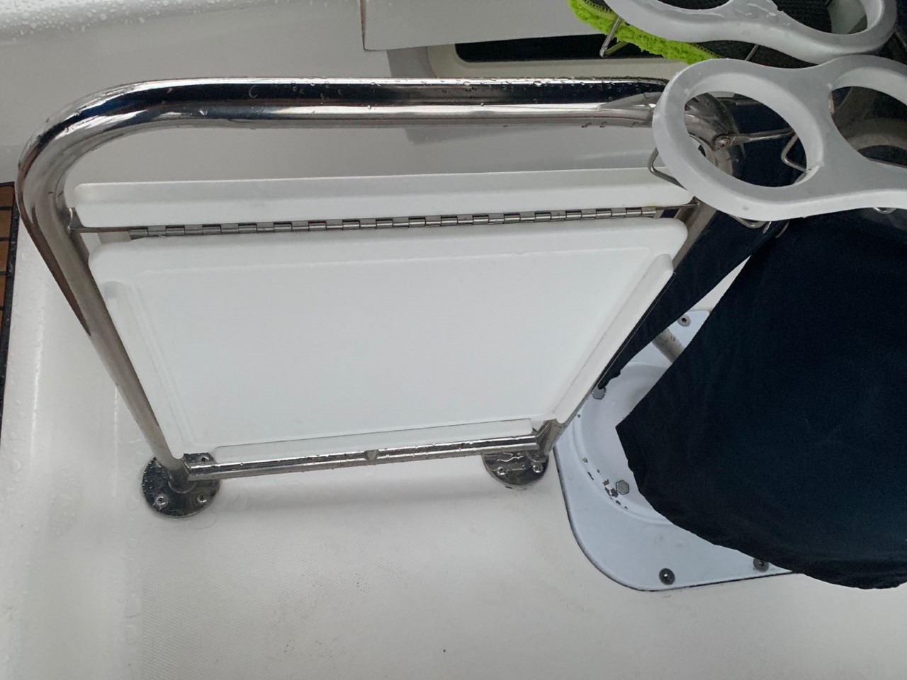

I'm thinking of removing the deck dining table. It takes up a lot of space and gets in our way most of the time.
Anyone removed one before? It appears to be just a handful of bolts. However, is there a cap to or a method to plug up the holes where the bolts are removed so that it doesn't become a hazard? Pictures attached..

I haven't removed the table just yet. I assume that the bolts once removed if not sealed back correctly can cause a leak into the cabin?

That's not just a table, it's a hand hold and a foot rest, both very handy on a heel. But after all it's your boat.

In bad weather I'll tether myself in and it wouldn't be the table that's for certain. I've sailed the boat and keeled and never used the table. Never used as a foot rest or dinning for that matter. In fact this table is more of a problem than helping.
I'm all about safety and this table design should have been moved elsewhere. Where I don't know. But walking around a table jumping like monkey is not for me. Take 4-5 friends on and everyone is hopping like snap n pops from the 70s.
I went out and purchased 4200 and plan to take the table out. Anyone need a table? It's in brand new perfect condition. And thank you everyone for suggestions and comments. All taken and appreciated!

Just remove the screws and coat the holes with epoxy. Finish the job by toping the holes with gel coat.
I agree with Benny on this. I removed something that was bolted through the cockpit sole on my C36 ( a steering control bracket). I just put the carriage bolts back in with some sealer. I cursed those every time I stepped on them barefoot!
You can just put a piece of masking tape on the bottom of the hole, and dribble some five minute epoxy into the hole 'til it's almost level. When it's hard, finish with some gel coat. Cover with saran wrap 'til it cures (gel coat cures in the absence of oxygen). You'll have nice, white, nondescript spots where the holes were.

You might want keep it.
That is a Grab Bar and place to hook a life line tether. Safety is high seas and a place to grab when standing up in the cockpit.
The dinning table fold out is just a "add on" combination.

There should be an access panel below to those "bolts", normally over the aft berth.
Since they are isolated from the boat grounding system, one of the few metal parts you can hold on too, in a storm, that has some lightning.
