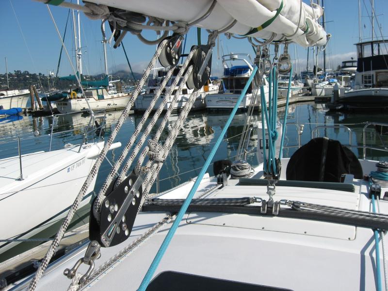

Just finished sanding and treating my above deck highly weathered woodwork. I now need to remove my companioway hatch to replace the 3/4" x 1/4" trim piece that is at the aft end of the hatch and glides on the metal side rails. Mine broke somtime ago. Problem is what to expect to remove the hatch. I assume that I remove the screwed on metal deck that is above the opened hatch. Mine has screws on the side and a caulked seam. Anybody have further info on what I can expect to find below? I know there is a trim piece that stops the hatch from sliding further aft than the closed position.
1,066
Jim,
From your picture, I would say your companionway hatch is quite different than my H37C hatch. On the 37, the cover over the sliding part extends further forward and also all the way aft on the side (it covers the side edges of the sliding part). I have avoided disassembling mine to date since there are a lot of screws and caulking to remove!
1,483
I'm with Jim. My hatch doesn't look anything like you photo. God only knows what you will find.
Jun 2, 2004
5,802
Appears to me that once removed the top should slide our forward. Is that traveler original? Can you remove the spray hood without removing the traveler? Looks like it sits right in the hood. Like Jim says, ours are different. From the picture I guess ours would lift out, not slide forward or aft. Maybe yours will be the same.

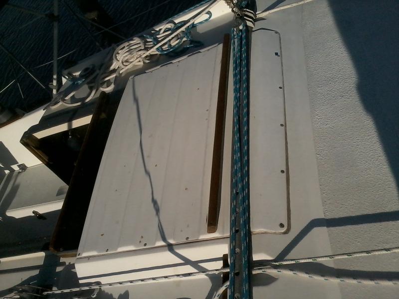

I've wanted to take my clamshell off also. Everything is working underneath right now, but I know its a matter of time before the wood pieces wear enough to affect smooth operation of the lexan sliding hatch. But from what I can determine, the traveler rail must be removed first. And the long attachment screws on each side have resisted all attempts to remove ... PB Blaster and even some propane heating. Eventually I'll need to do it ... maybe by grinding the screw heads off?
I am not at my normal computer now. I might have a picture on it that will present better than Jim's.
The traveler is the original equipment on the 80-82 36'er. The deck FRP is custom molded to mount it.

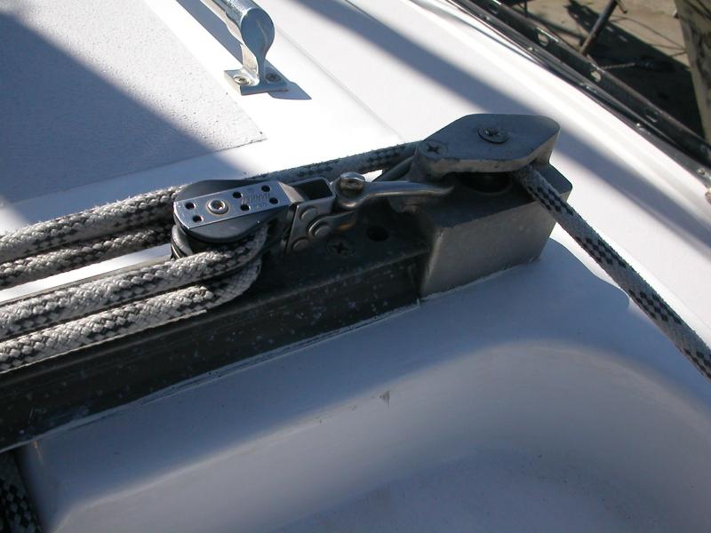

The attached pictures show how/where the Cherubini H36 traveler is mounted over the companionway sliding hatch protective clamshell.
The closeup shows the starboard side cast stainless block fitting that serves to route the traveler line back towards the cockpit and also to secure the traveler rail onto the boat. The same fitting is mirrored on the other side. The SS machine screws (1/4" diameter from memory) go down through it into the deck. I am not sure if Hunter embedded an aluminum plate under the area and threaded into it. Or between the deck and the liner are nuts and a backing plate. But in any case, all but one of the screws won't budge. And the screw I did get to turn locked up after about 1/4-3/8" removed.
In my last post, I forgot to include that I tried an impact extractor as well. But I didn't want to whack it too hard for fear of doing collateral damage somewhere!
